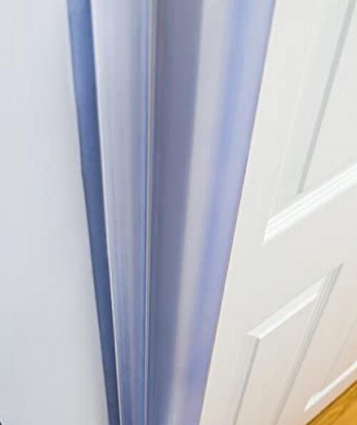

If by "Rubber edgings"  you mean similar to the picture below (I couldn't find a decent picture of an opaque one) these are actually "finger guards" (So usually children) can not get their fingers trapped as the door closes, most, not all are  NOT fire resistant. If they would be allowed for your purpose, I do not know.
Right okay thanks for the info. - Yes it was the finger guards I just searched them up. I will look to get the gaps reduced with seals and strips and then install these as an additional measure or try and find a fire resisting type.
