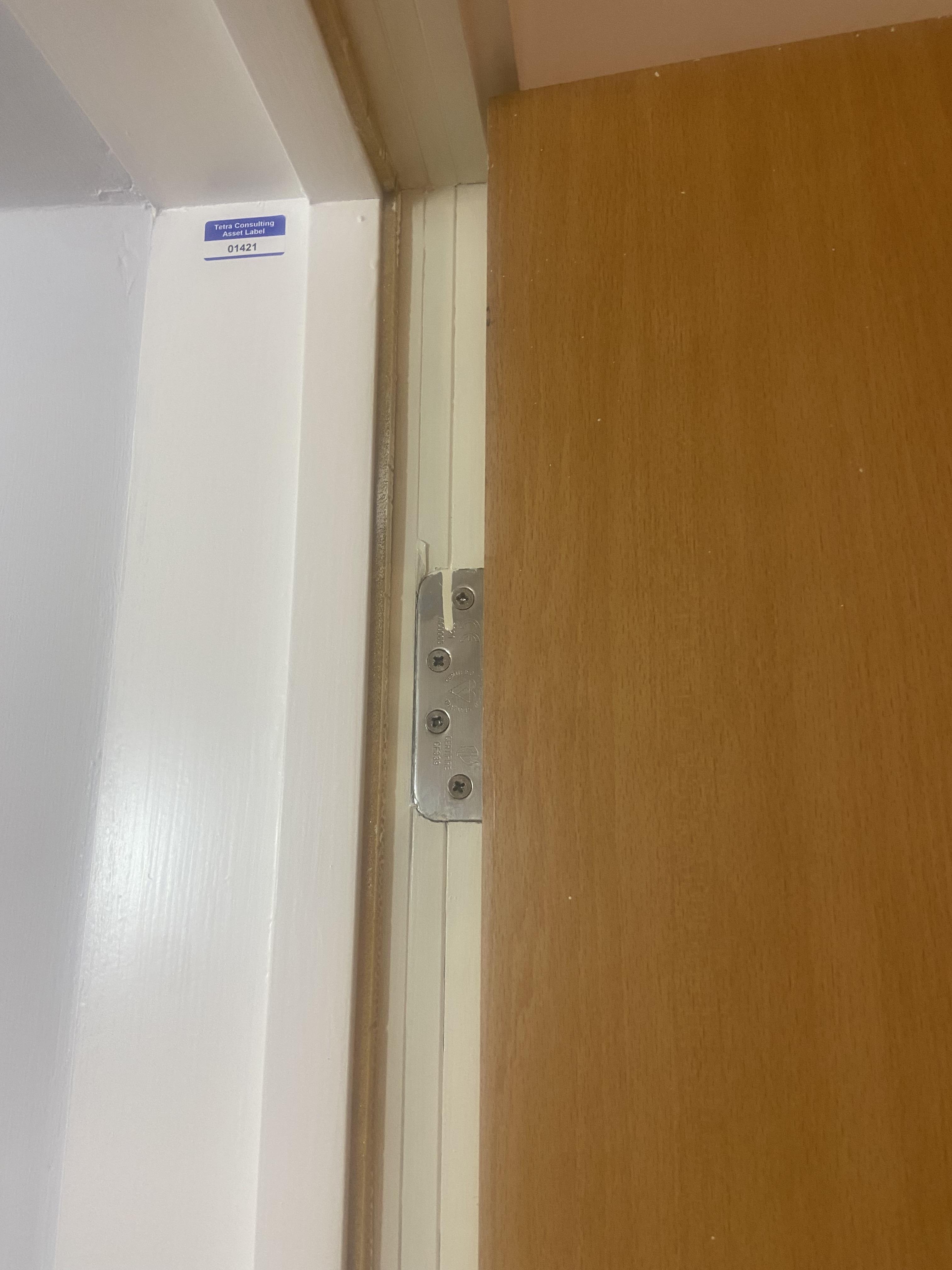

Propose to fit new intumescent strip / smoke seal to an existing d30 fire door, if a gap of 4mm between frame and door is evident on one side of door viewed from inside.Is it necessary to remove door , architrave and increase frame or can you alternatively plant a new lining on the outside frame to increase the rebate to 25mm.( also still fitting the strip / smoke seals ?) and will this method be Certified as acceptable practice.
Posted
"Propose to fit new intumescent strip / smoke seal to an existing d30 fire door, if a gap of 4mm between frame and door is evident on one side of door viewed from inside.Is it necessary to remove door , architrave and increase frame or can you alternatively plant a new lining on the outside frame to increase the rebate to 25mm.( al  so still fitting the strip / smoke seals ?) and will this method be Certified as acceptable practice".
There appears to be an intumescent strip already fitted and if the door to frame gap is already 4mm, then it complies with BS 8214: 2016. Why not just fit a smoke seal to the push side on rebate stop?
Why do you require a 25mm rebate? This is unnecessary.
The products you purchase for this task should carry product certification.
Posted
The inch/25mm rebate/stop harks back to before intumescent seals existed so as Neil says no need to make a frame up to that on a newer door set
