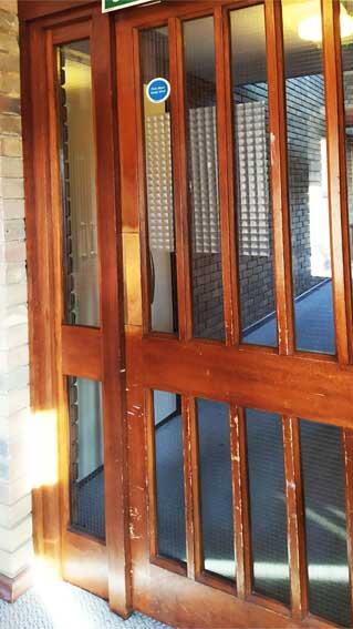

delboy Posted October 22, 2021 Author Report Posted October 22, 2021 Here is an image of the doors as they are today. I heard that the company quoting for the job has spoken with a local Safety Officer (no idea who they are talking about) presumably from the council, but these flats are ALL private and nothing to do with the council. Doors are all sound but at 30 years old do have the odd nick on them, but thats about it as far as I can see. Quote
Neil ashdown Posted October 26, 2021 Report Posted October 26, 2021 So have they given a reason why they must be replaced? Quote
AnthonyB Posted October 26, 2021 Report Posted October 26, 2021 They do look like the original fire doors that are to the standard of the time with the upgrades as already mentioned. They would be acceptable under both the existing flats guidance and based on the draft for consultation would still be acceptable under the new small blocks of flats guidance produced to account for the Fire Safety Act's amendment of the fire safety order. Unless you see something in writing from the Council that you have verified is really from them I'd do nothing and even if something does then I'd ask a competent person to look at their rationale & put forward a rebuttal if needed. Could be a confidence trick, wouldn't be the first fire safety related one I've heard of. Quote

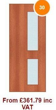

delboy Posted October 27, 2021 Author Report Posted October 27, 2021 16 minutes ago, AnthonyB said: It's still not a requirement for the door to have a certification mark, it makes identifying the door more difficult but isn't the end of the world. It's far easier to rebead the glazing with the correct intumescent than replace the door and frame (if they don't replace the frame then any new door certificate would be invalid as certification is for door sets (frame, ironmongery, etc) not just the door. Thanks, really interesting...they are actually quoting for the doors like this (image attached from your site), and are saying that they can no longer use doors like the existing ones? ...........Not allowed. (local safety officer, still unknown) As you can appreciate they will just not match up in any way and look hideous, without matching frames, and then the cost will more than double But if they are NOT allowed, how can they leave the side glazed frames in place? Which part is not liked....a 44mm solid hardwood door or the glazing. And you can see that the frame also has a side glazed attached to the wall. No mention of new frames is mentioned at all, despite being space to say that (well not until they start I wouldn`t be surprised). In fact they do mention that sealant is needed between frame and wall, for which they have included a cost £130 per door frame This is fast becoming an issue. Section 20 has been issued and looks like they will railroad this through. Quote

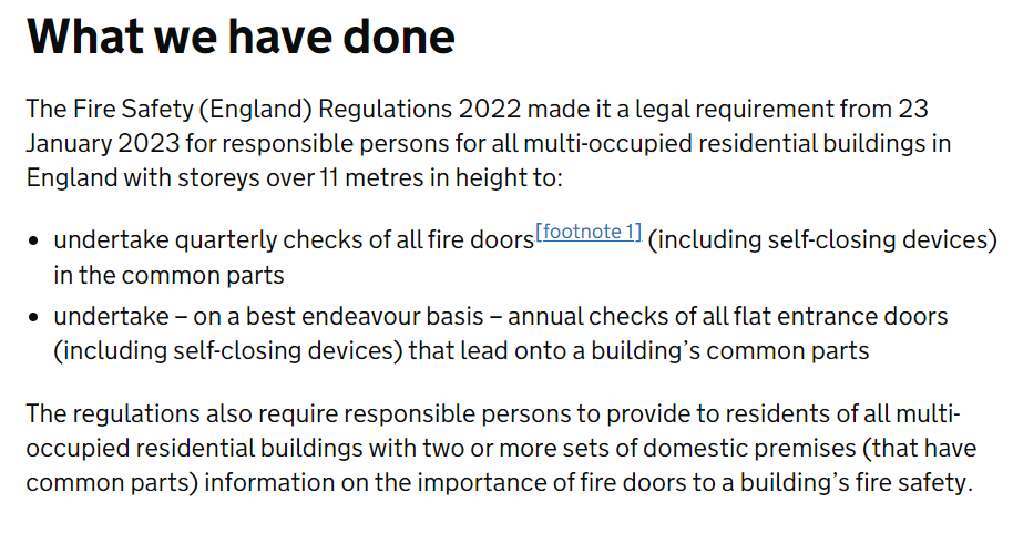

delboy Posted March 31, 2023 Author Report Posted March 31, 2023 Here is an update to this now old post. After many attempts to get the MA to see sense, they finally agreed to meet another Fire company to look at the cross lobby doors...............upshot of that is that they were told that new doors are not needed, due to the distance of flat doors from stairways ...so a huge saving to leaseholders in unnecessary expense, due to dogmatic approach bt MA. However despite that, no works have, as yet, been carried out from the FRA recommendations done in June 2020 !!!!! Now they are telling us that we must have annual checks, both internal and external. to all flat doors So now another discussion ensues........The blocks of PB flats are less than 11mtrs tall, at the height of the top floor floor (In fact its only a 3 storey property, GF/FF/SF). As I read the Regulation 10 of the updated Fire Safety report (Feb 2023) only if a building is more than 11mtrs tall (at level of top floor floor) is an annual check required. Am I reading this all wrong? Of course from my viewpoint I would say that any/all occupiers, whether owner occupiers or tenants should do this every day, let alone every year. As far as I see it it is just another tick box exercise, to cover the Freeholder, because like an MOT on a car, its only good on the day its done, and therefore, only suggests safety on 1 day out of 365.t day Quote
Neil Ashdown MAFDI Posted April 3, 2023 Report Posted April 3, 2023 Regulation 10: https://www.gov.uk/government/publications/fire-safety-england-regulations-2022/fact-sheet-fire-doors-regulation-10 I would interpret this to mean the 'total height of all storeys combined'. Quote
AnthonyB Posted April 3, 2023 Report Posted April 3, 2023 The Government guidance clearly states that buildings with the floor of the top storey under 11m are not exempt from the need for fire door checks under Article 17 of the Fire Safety Order, only that the frequency of those checks is not prescriptive as per the Fire Safety (England) Regulations, for example a smaller block may decide through their risk assessment to only check communal doors 6 monthly and only check a percentage of flat doors annually rather than trying to check all of them. Quote
