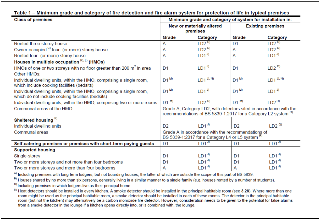

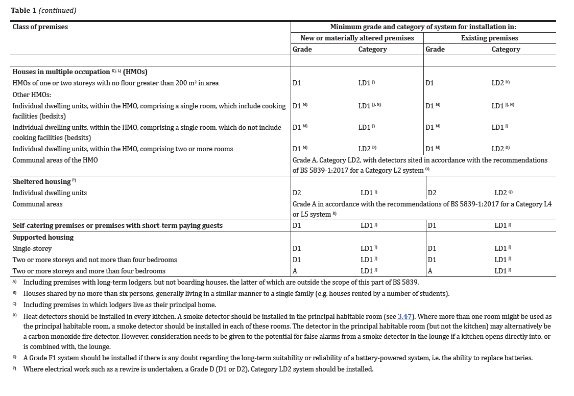

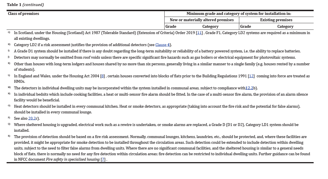

I was wondering if anyone on here owned a copy of BS5839-6:2019 and could please tell me the wording of footnote K and footnote L in Table 1. For example, in Table 1 the wording of footnote (A) is "Including premises with long-term lodgers, but not boarding houses, the latter of which are outside the scope of this part of BS 5839."
I have attached an image of Table 1 from BS5839-6:2019 which shows the wording of footnotes A, B, C and D. However, I do not have the wording for the other footnotes and I am interested to see the wording of footnotes K and L (which as you can see in the attached image are related to Houses in multiple occupation (HMOs)).
