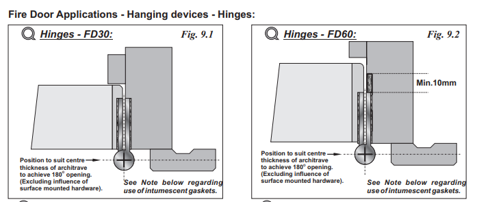

Guest Jamie Posted March 25, 2022 Report Posted March 25, 2022 Hi, We've recently had a fire door survey carried out and I queried the fact that there was gaps around the hinges where they've recently been replaced with a different style of hinge therefore it's left gaps around the hinge. I've been told by the contractors that this isn't an issue because they've put intumescent packing behind the hinges. Can someone confirm if this is acceptable? In addition, the contractor also advised this has only been done for the 60 minute FD not the 30 minute FD's as it's not required for them... Again, can someone confirm if this is correct? Thanks Quote
Neil ashdown Posted March 31, 2022 Report Posted March 31, 2022 I am not aware of any evidence of fire performance that deals with gaps around hinges but clearly the expectation would be that the mortice work for any door ironmongery should be as tight as possible with no large gaps. Below is from https://www.falconpp.co.uk/media/1328/09_strebord_v91_section_9_hardware_rev_a.pdf so applies to that particular door. Quote
