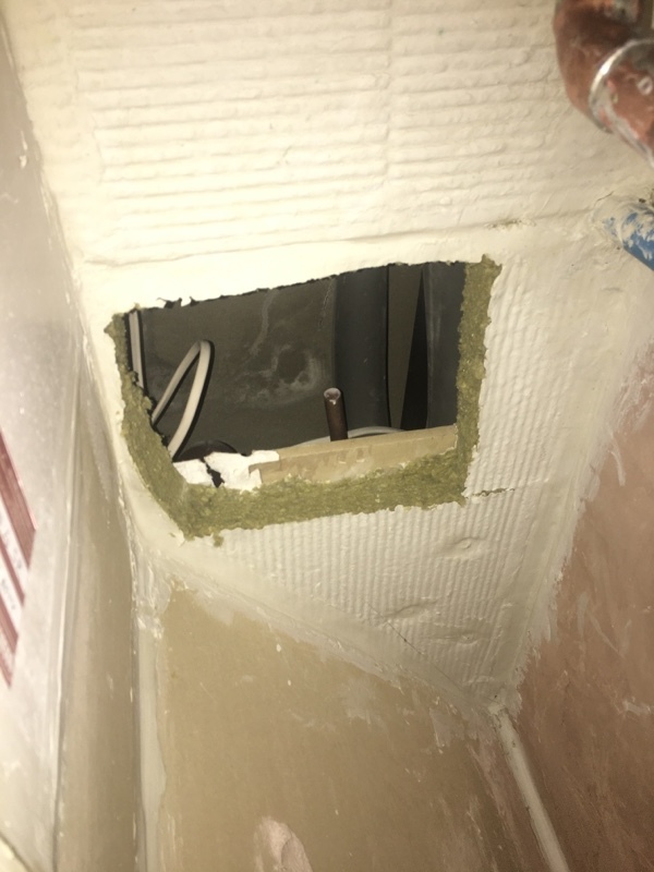

Is it acceptable to patch repair fire batt? Please see attached. Penetrations have been cut to allow access for maintenance.
Would it be acceptable to either
a) reuse the section of fire batt removed if still intact
b) use new fire batt - being unaware of the spec/make of the original installation.
c) Pattress over
Or would this be a straight rip out and new install?

On 18/05/2021 at 13:34, Mike North said:
I would rip outs the piece of bat that has the hole in it and renew it with a fire rated hatch in case you need access again
Fire rated hatch fixed to fire batt? I don't think that would be suitable.
Obviously remove the existing bat, install a suitable framework, then install the hatch, then make good with bat correctly around the hatch. All the above using 3rd party accredited materials and contractors.
