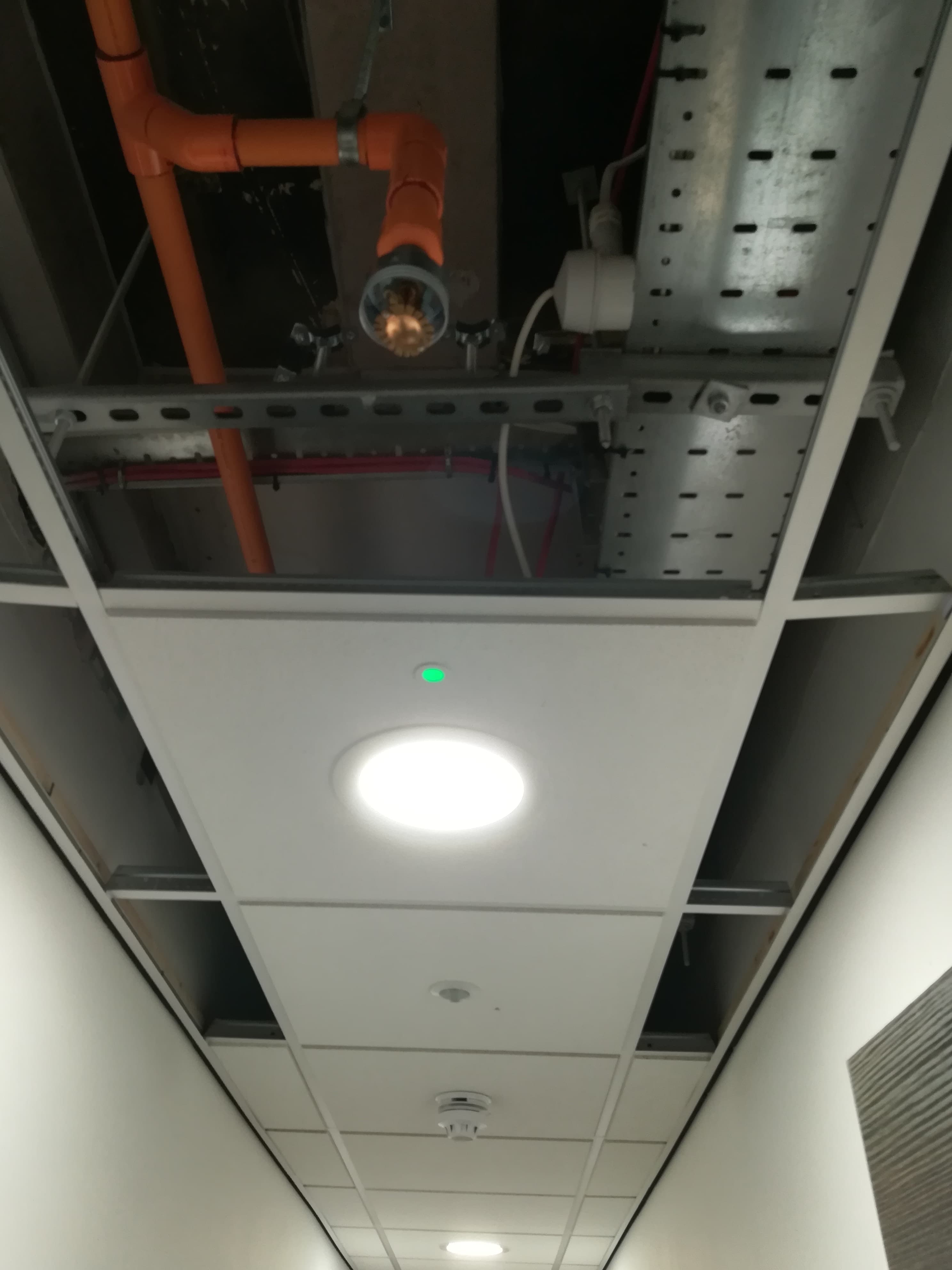

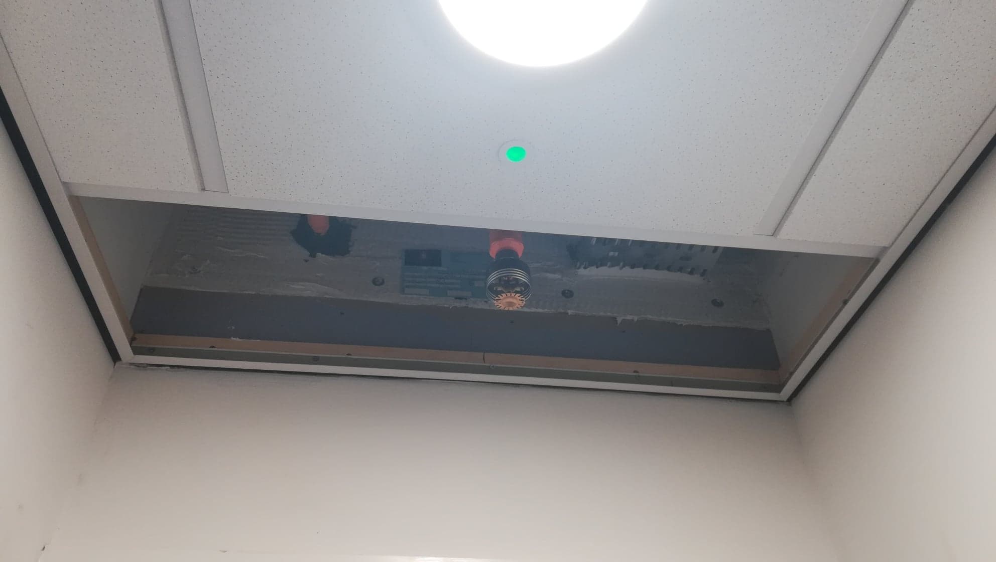

Andy Terry Posted May 10, 2021 Report Posted May 10, 2021 Hi, I hope you are able to help. My son had a room in a private halls of residents whilst at university. This was a new-build and the suspended ceiling outside his room door was missing tiles, especially around the smoke detector and sprinkler system; the corridor outside his room was a protected escape route. He was on the ground floor; his window led into an inner courtyard with two fire escape routes, however his window was locked to tilt only. The landlord's contractor said that there wasn't an issue if the tiles were missing. I have photos attached and would value your opinion on this matter. Thank you, Andy. Quote
AnthonyB Posted May 10, 2021 Report Posted May 10, 2021 At least it allows me to see the firestopping appears correct! The tiles don't appear to be part of the compartmentation, the usual issue with the odd missing tile is allowing smoke and combustion products to spread un-noticed and, if the void has no detectors, allow the fire to develop more before detection is activated as the rising smoke enters and layers above the corridor detectors. Quote

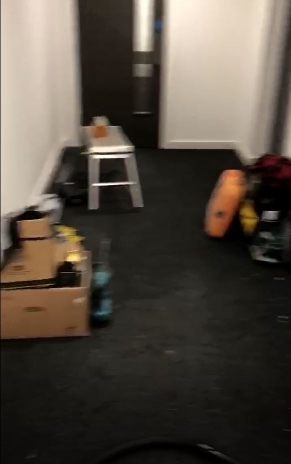

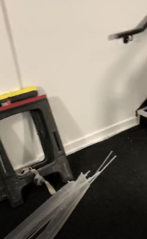

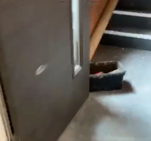

Andy Terry Posted May 11, 2021 Author Report Posted May 11, 2021 Thanks AnthonyB, the voids are at either end of the corridor. There were missing tiles in main corridors too. Builder wedged fire door open and the corridors were littered with their tools etc. Quote
AnthonyB Posted May 11, 2021 Report Posted May 11, 2021 Oh dear, looks like occupancy before completion, a common trick to get money in to help cash flow. Fire Service enforcement probably wouldn't get too bothered about the tiles, but they may well be interested in these conditions. Quote

Mike North Posted May 18, 2021 Report Posted May 18, 2021 Although it does not look nice, the ceiling tiles are not there for fire protection merely for decoration the fire stopping is above the sprinkler head, the black intumescent that can be seen in the second image appears to be adequate. Unfortunately, the occupation has happened before practical completion, shouldn’t happen but it does, as long as a clear thoroughfare is kept it is not an issue. As long as someone in close proximity is in control of the of the door again, I do not see it as an issue. Quote
