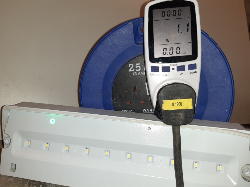

To be fair as EL fittings are almost invariably LED the electricity usage is minimal compared to the old fluorescent tube units.
Regarding cost of electricity, it's not even worth thinking about. They will probably be 2 or 3W LED units.
At a combined wattage of 8W, the units will cost around £11/year. They could save a life, that's why they are required.
