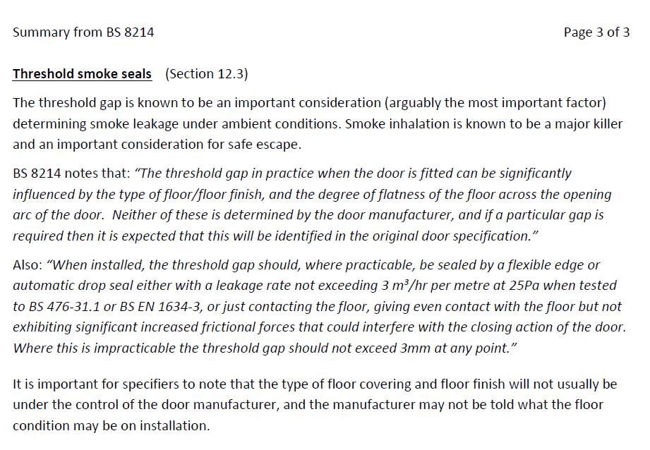

The following is from ASDMA on BS 8214:

If there is no pressurisation present, then the only statutory requirement is for the head and jambs to resist passage of cold smoke, I would be happy with up to a 10 mm gap at the threshold provided that the door certification allows for it.
That is mine and also Exova Warringtomfire understanding of the current regs.
