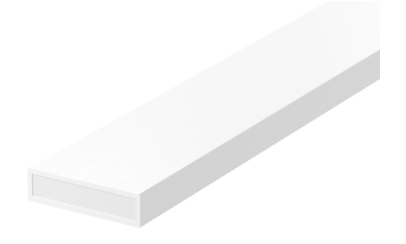

If the noise is a problem you could change the seals (all of them) for fire only seals (below) used in conjunction with the type of smoke/acoustic seal (bottom).
image.png.df4b974adbcf3add0cc215f990dc707c.pngimage.png.a66c661d77d92d2fc517d42eb58faec9.png
