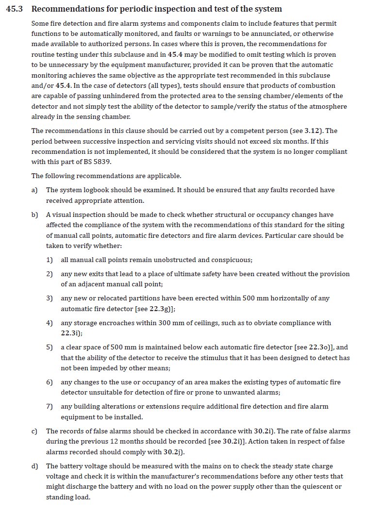

Ultimately you are legally responsible and have to demonstrate adequacy of your system of maintenance whether carried out yourself or by others - are you happy you could defend your position in interview and at Court? If so you should be fine if you feel competence can be demonstrated and the correct service completed.
