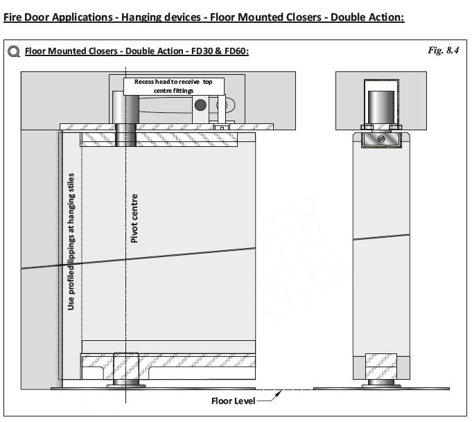

For a double-swing-action timber-based fire door it will be necessary to use pivots instead of hinges.  It will likely be necessary to use a floor=spring instead of an overhead self-closing device.
Not all timber-based fire doors will be suitable for this application, so consult a specialist fire door supplier/manufacturer. And follow the installation instructions for that particular door leaf.

If the doors are fire resisting doors, then in order to be compliant to the Standard the minimum and maximum gaps will need to be achieved.  BS 8214: 2016 guidance states  2mm to 4mm at the top edges & vertical edges and the threshold gap should be to the door manufacturers installation instructions (usually 6mm to 10mm). This can be difficult to achieve for double-action doors.
If the doors are required to provide 'restricted smoke spread' then the smoke seals should seal the operating gaps, including at the threshold.
BS 8214 https://shop.bsigroup.com/products/timber-based-fire-door-assemblies-code-of-practice/standard
Clearly, intumescent edge seals and most likely smoke seals will be required.
