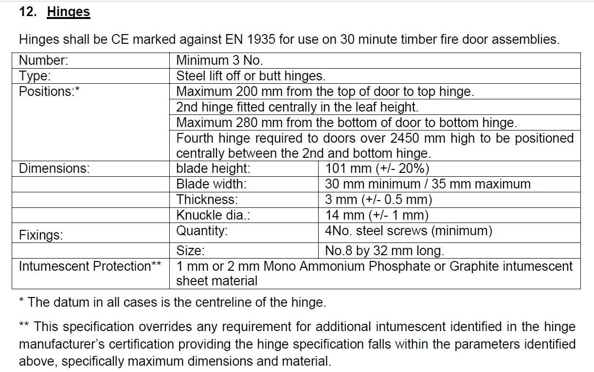

Be careful about generalisation with regard to timber-based fire door installation requirements.  The image below is an example of intumescent gasket requirements for hinges for an FD30 timber-based fire door:
