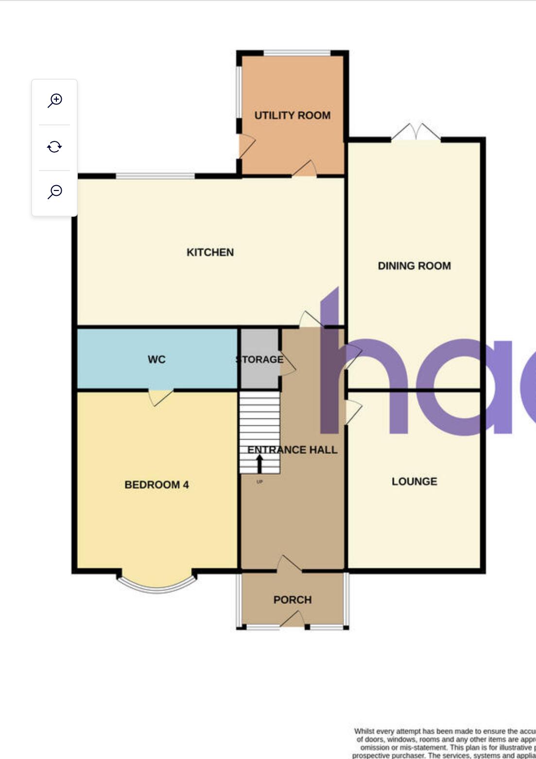

Are there any fire regulations for a small enclosed porch on a children’s home apart from smoke detection and thumb turn locks on the doors? I have attached a picture.
Regards Mark
You would need to review your FRA, but there should be no major impact beyond that you've said depending on the use of the room. You may need to consider emergency lighting if part of an escape route.
