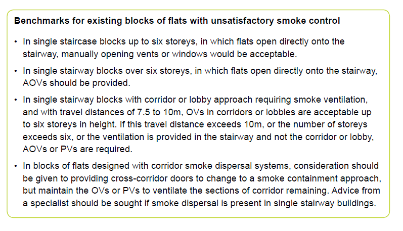

Guest Martin Posted August 27, 2024 Report Posted August 27, 2024 On 18/11/2020 at 18:01, AnthonyB said: Required in some form since the early 60's. The official guidance (LGA Guide) has a timeline of requirements, mostly in CP3 until 1991 when Approved Document B was introduced. In some cases it was a simple as having openable windows on landings or a permanent vent at the top as oppose to powered auto vents but in anything other than the smallest blocks is been a requirement for decades. Worryingly too many fire risk assessors are ignorant of this and miss it out of their FRAs So are the OV’s and PV’s in place in high rise stairwells/lobby’s still suitable and sufficient? Or must they be upgraded to AOV? Even when it is not proportionate to the risk. Quote
AnthonyB Posted August 28, 2024 Report Posted August 28, 2024 It depends on the risk- the guidance is reasonably proportionate in retrospective requirements: Quote
