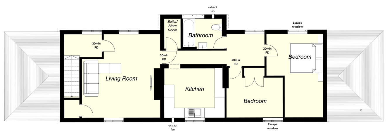

TopperUK Posted June 4, 2020 Report Posted June 4, 2020 I hope someone can help, thanks in advance for any advice. I'm renovating my former two storey office premises to add two x one bedroom flats to the ground floor and I currently live in the first floor flat. Each flat has it's own separate entrance and there are no communal areas, the first floor flat is less than 4.5m from the ground. I'm looking to rent out all three flats on completion and just want some advice on fire doors for the upstairs flat. The architect showed lots of fire doors upstairs but I think this was because there wasn't a door on the kitchen when he did the plans. There is now a standard door on the kitchen, would we still need fire doors on all the doors as per the plans below which show the ground floor entrance and the first floor flat layout (without the kitchen door)? Every room except the bathroom has a means of escape window. Would just fire doors on the kitchen and the boiler room suffice? As we will be living in the flat while work is going on, the fewer doors we need to replace wth fire doors the better to minimise mess and disruption, but obviously we want to keep within regulations. Many thanks Quote
AnthonyB Posted June 4, 2020 Report Posted June 4, 2020 You will find your answers here: https://assets.publishing.service.gov.uk/government/uploads/system/uploads/attachment_data/file/832631/Approved_Document_B__fire_safety__volume_1_-_2019_edition.pdf In the old days often only kitchen and living room doors were fire doors, now they all have to be other than the bathroom. They don't, however, need self closers or intumescent strips. Quote
TopperUK Posted June 5, 2020 Author Report Posted June 5, 2020 Thanks for the response. Reading through the document, am I right in saying that although the building has been split into three separate residentuial units, as each unit has its own independent external entrance (onto the street), there are no communal areas and the first floor flat is less than 4.5m from the ground, they would each be classed as a dwellinghouse rather than a flat with regards Section 2 means of escape regulations? If classed as dwellinghouses, I can't see anything definitive saying that all doors in the upstairs flat need to be fire doors unless I'm missing something? All habitable rooms have escape windows and as said above, all units have indepenedent external entrances and below 4.5m. You say all rooms in the upstairs flat now need to be fire doors, is that because to get access to the external entrance you have to go through the lounge? Quote
AnthonyB Posted June 5, 2020 Report Posted June 5, 2020 I'm used to houses of more than one storey and flats in blocks, the latter using the protected hall approach and requiring the requisite doors as per Table C. At the end of the day it's a Building Control matter and LABC or your AI will decide how to interpret the guidance. Mostly the internal doors are FD20 doors, which is usually an FD30 blank without the intumescent strips. Every new build flat I've been to has this set up. Quote
