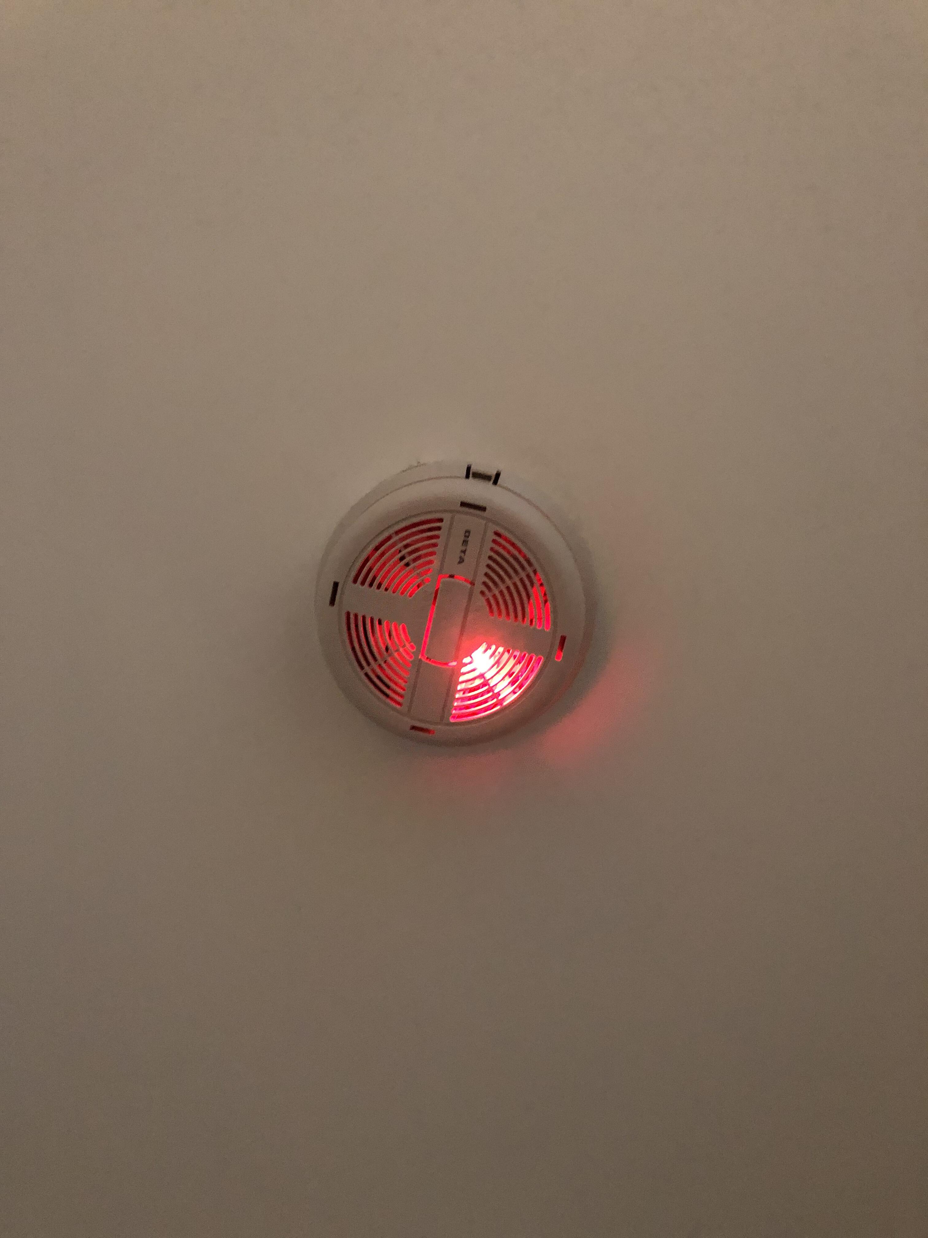

Guest Lee Posted April 25, 2021 Report Posted April 25, 2021 I am having same issue,3.30 in morning,jumped out of bed,found top floor unit beeping 3 times,red light comes on every 15 secs.is this the same problem Quote
green-foam Posted April 26, 2021 Report Posted April 26, 2021 Without having the unit to test, unfortunately it is not possible to give you a definitive answer. But I can say if your smoke alarm is 10 years old then you should change it. Quote

Guest Red light on Posted February 18, 2022 Report Posted February 18, 2022 Am having the same problem as Guest Red Smoke since the power outage. Have replaced the battery but the solid red light stays on...it is 5 yrs old from a new build too. Tried the pressing down test button for 30s but no luck. Quote
green-foam Posted February 21, 2022 Report Posted February 21, 2022 Did you take it down, remove the battery then press and hold the test button? If yours is a Deta 1153 they are obsolete, and if the suggestion does not work, then you will have to change it. Quote
