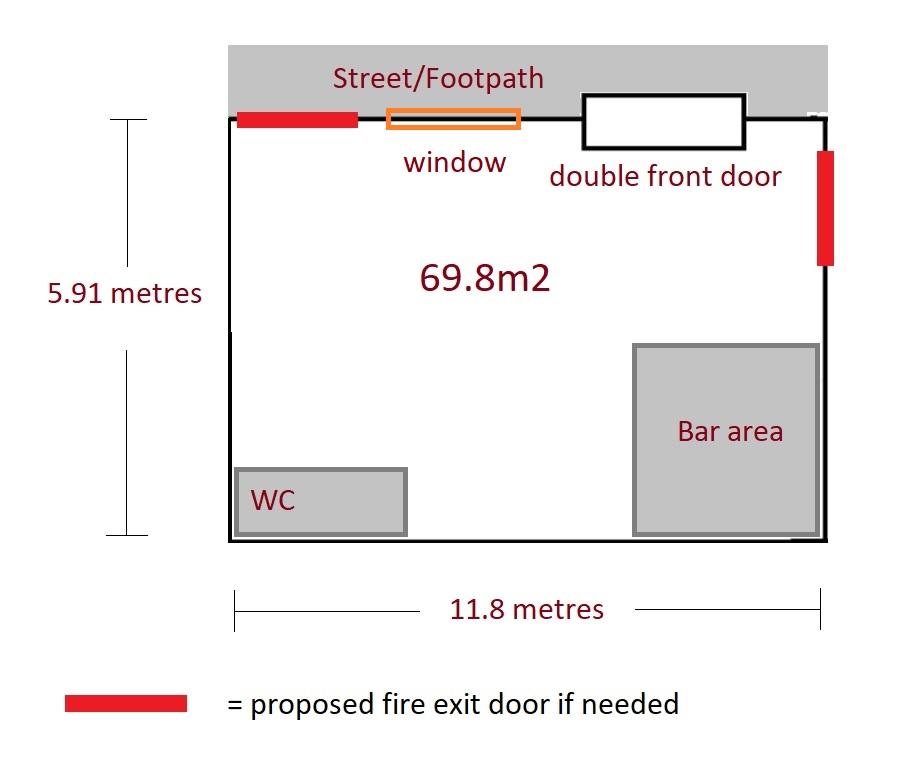

I am looking to rent out a commercial unit as a cafe in Bury town centre but there is no current secondary means of fire escape. Please can you look at the rough plan to see if I would need to install a secondary fire escape or if one door would suffice?

14 hours ago, AnthonyB said:
Based on your measurements and assuming an occupancy of under 60 then the one door is acceptable.
 Sorry I am afraid they will most likely chase you as they usually do not give advice and most probably suggest you employ the services of a fire safety consultant.
