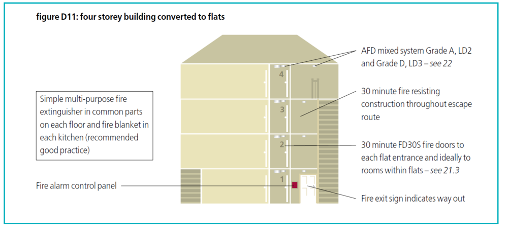

andre Posted January 7, 2020 Report Posted January 7, 2020 I would like to know if this is complies with bs5839 pt6. An existing system A 4 storey hmo split into 3 self contained flats with a communal staircase. The communal entrance and stairs has a fire alarm control panel with smokes, call points and sounders. Then each flat has its own mains wired smoke alarm in the entrance hall not interlinked and not wired to the control panel Quote

andre Posted January 11, 2020 Author Report Posted January 11, 2020 The property is not hmo Its a large house converted into 3 flats. The escape routes are fitted with 3 x smokes, 2 call points and 2 sounders. We would prefer not to extend the communal system into the flats due to problems with access and upheavel. Its much easier just to have the parts of the mixed systwms replaced. As long as this complies? Having the mxed system also appeals in case one is tampered. Quote
