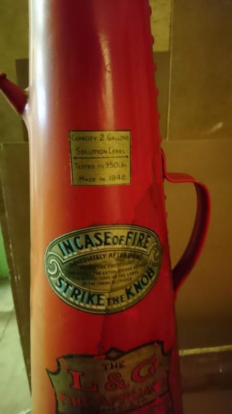

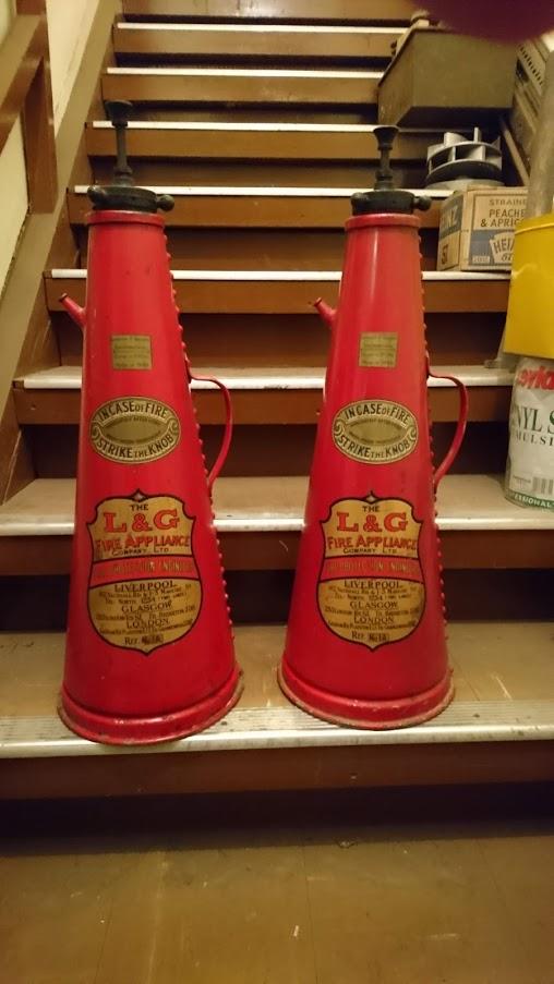

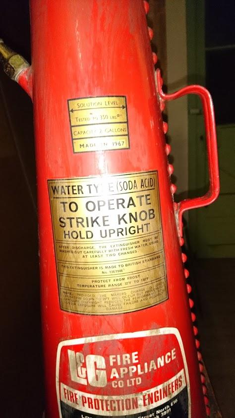

Guest LondonMan50 Posted December 10, 2019 Report Posted December 10, 2019 I have got 4 vintage fire extinguishers that I was thinking about selling. I came across them whilst tidying up my families old factory. I didn't want to just dispose of them as I know there are people out there who like to 'repurpose' these type of things. They were all made by 'The L&G Fire Appliance Company Ltd'. Three of them were made in 1948 and the other in 1967. All of them are still full and seemingly unused. On the label of the one made in 1967 it says it contains Soda Acid but on the others it doesn't say what it contains but I understand that it's probably Carbon Tetrachloride. My question is should I try and empty these things (or get a specialist to do it) before trying to sell them or just sell them as is? Quote
green-foam Posted December 10, 2019 Report Posted December 10, 2019 Carbon Tetrachloride was used in "car fire extinguishers" and the extinguisher itself looked like a big syringe. Yours being conical are soda acid Yours are full of sodium bicarbonate and a glass container of sulphuric acid, when the plunger is struck it breaks the glass container allowing the two to mix, producing carbon dioxide and "water" The carbon dioxide forces the water out. Being as old as they are short of chemically testing the acid and the bicarb you can not say if they will work, don't strike the plunger "to find out" as once started they can not be stopped. I wouldn't open them either, sulphuric acid is very corrosive. (But in its container, it is fine) If I were you I would list them on ebay as collection only, I doubt you will get that much for them but it all depends who wants them and can travel to you. Quote

AnthonyB Posted December 11, 2019 Report Posted December 11, 2019 In lovely condition for museum & collector purposes, too good to ruin & turn into a lamp. I wouldn't discharge them as the cylinder (well cone!) may be too corroded to stand the pressure, but would usually remove the acid bottle (carefully!) pour the soda solution into a bucket and (wearing the right PPE) crack the bottle into the soda to neutralise the acid. Wouldn't mind one myself! Quote

AnthonyB Posted December 13, 2019 Report Posted December 13, 2019 There is no extra value in being full, just risk. I empty all mine. External condition is the key to value. The tops come off anticlockwise, couple of taps on the lugs to loosen then slowly unscrew. You will see the cage and bottle at the top of the cylinder, gently lift it all out and you can pour out the contents. Quote
