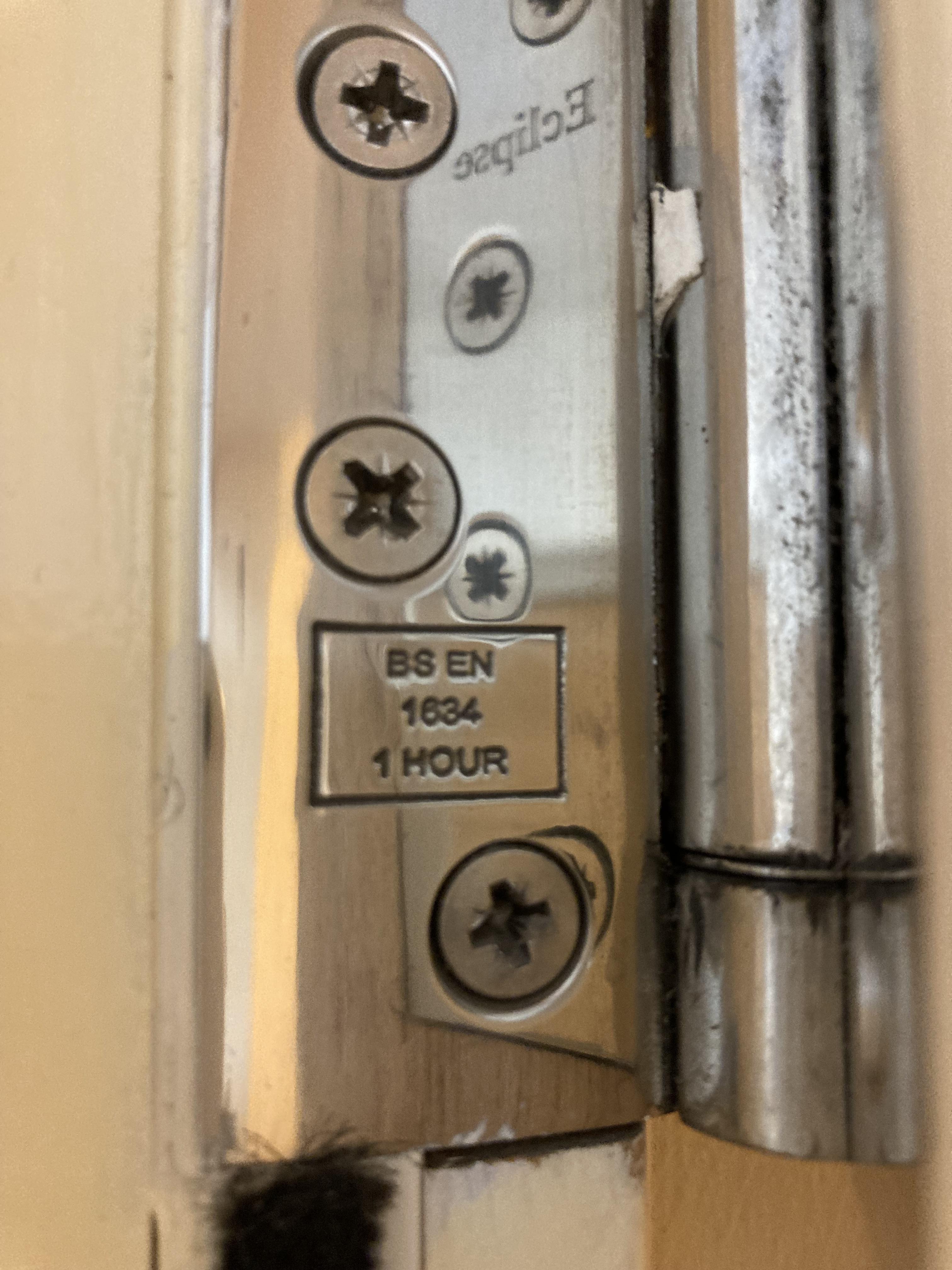

As Anthony has said, Construction Product Regulations are not applied retrospectively. There is no requirement to replace existing hinges because they don't have a CE or UKCA mark. Current building regulations (Approved Document B Appendix C) require that:  image.png.6d19b243acaa3e6bbaddfa20b4896703.png
