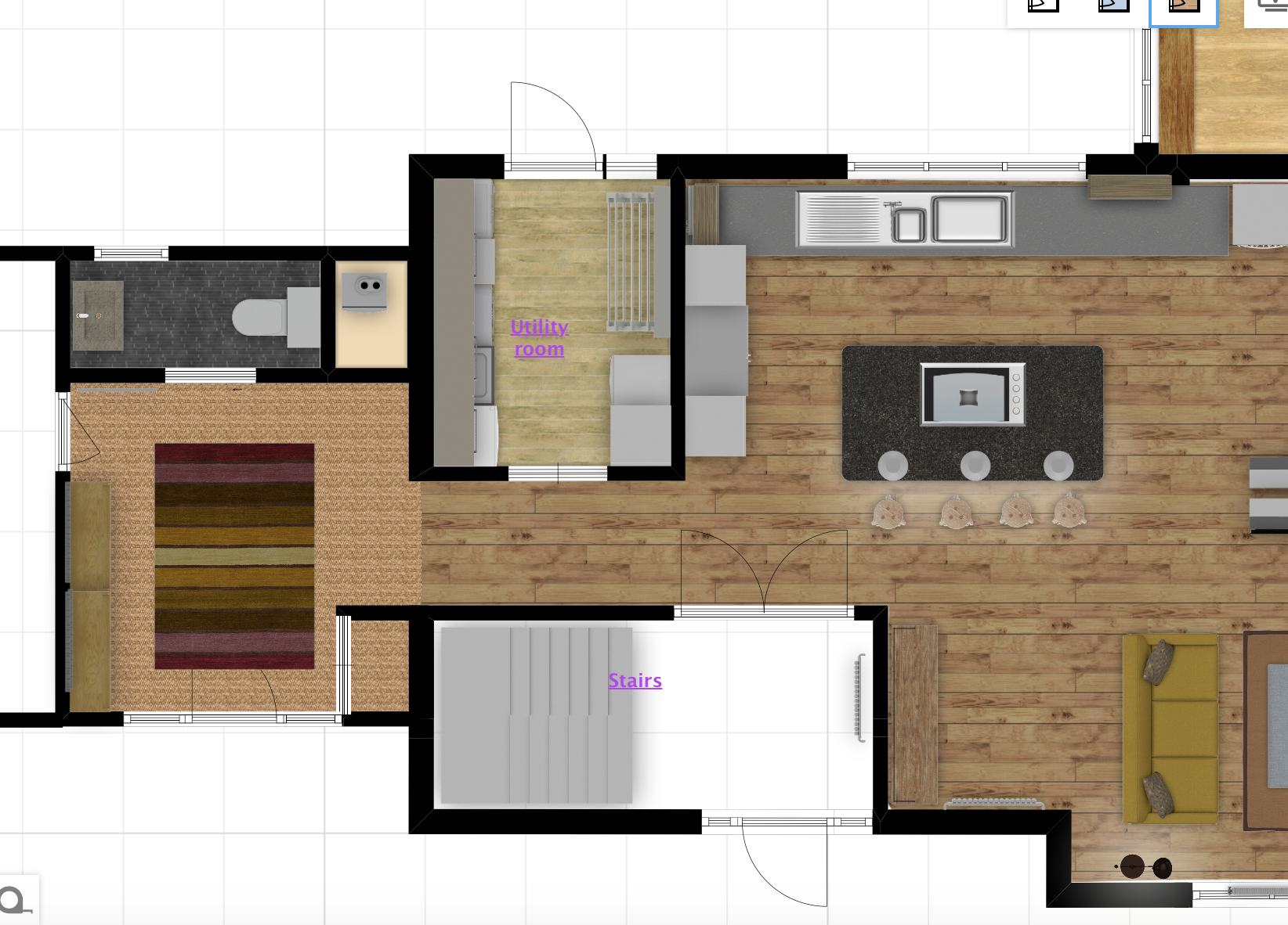

Guest Louise Jackson Posted September 5, 2019 Report Posted September 5, 2019 Hi - I'd love some advice on fire door requirements following some house 'remodelling' work which has just started. I have attached the new plan which I hope is visible and clear! Our house is three storeys - including a converted loft. Three queries: 1. the door between the utility room and hall corridor - does this need to be a fire door? There will be a door to the garden from the other side of the utility 2.the double doors at the bottom of the stairs - these need to be fire doors. Can they be glazed? 3. do bathroom and shower room doors on the first floor need to be fire doors? Thanks so much! Quote
Tom Sutton Posted September 6, 2019 Report Posted September 6, 2019 Is this a single domestic dwelling because will dictate the guidance to used and a architectural drawing or a single line drawing would be much better, also showing the whole of the floor area.The plans you submitted to building control would be ideal. Quote

Wheezy Jackson Posted September 6, 2019 Report Posted September 6, 2019 Not a great image, but this has been seen and discussed with our building control officer. I didn't ask him the detail on the doors at the time (but should have!). I realise the double hall doors will have to open the direction of exit... Floorplan Version II.pdf Quote
Tom Sutton Posted September 7, 2019 Report Posted September 7, 2019 Being a private domestic premises you are not subject to The Regulatory Reform (Fire Safety) Order 2005 but are to the Building Regulations and I would suggest you use Approved Document B (Fire Safety) Vol 1 as a guide. It is usual accepted that any escape doors catering for less that sixty persons can open inwards so double hall doors will not have to open the direction of exit. To your three questions, 1. the door between the utility room and hall corridor - does this need to be a fire door? There will be a door to the garden from the other side of the utility. No , as the utility room does not need to be a fire resistance construction and there is an alternate means of escape, providing you can get from the garden to the public thoroughfare. 2.the double doors at the bottom of the stairs - these need to be fire doors. Can they be glazed? Yes providing they meet a full 30 minutes fire resistance as these doors require to be FD30 fire doors also the cupboard under the stairs need the meet a full 30 minutes fire resistance. 3. do bathroom and shower room doors on the first floor need to be fire doors? No, providing there are no sources of ignition in either. Has your plans been passed if they have I am surprised these points were not raise with you. Without having a intimate knowledge of the premises I cannot be definitive but I am sure these points will be raised when visited by the BC/AI if not discussed at planning stage. Quote
