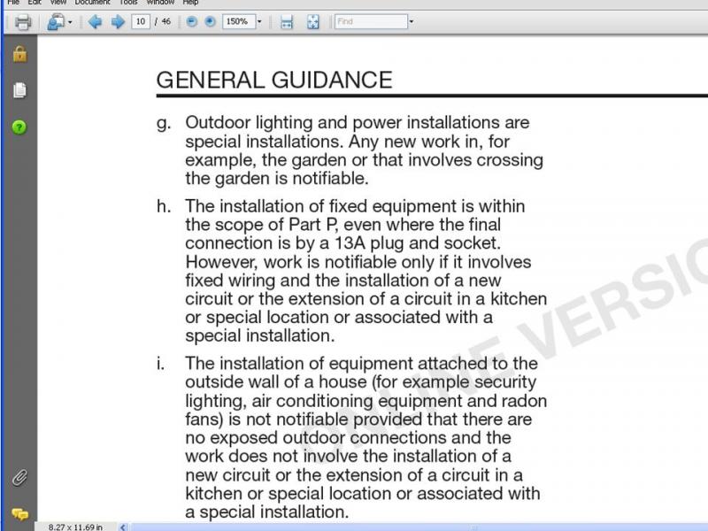

August 31, 20197 yr comment_15088 It depends if the work is notifiable under approved Document P and under h it appears it is not, as you are using existing wiring but I would check it out with the LCBC. (building control) Report
August 31, 20197 yr comment_15090 I would suggest that as it is changing smoke detectors it has nothing to do with part p, since there is nothing new being added, I would however suggest that it has to be done by a competent person, a competent person does not have to be an electrician, but does need to know what they are doing. Report
