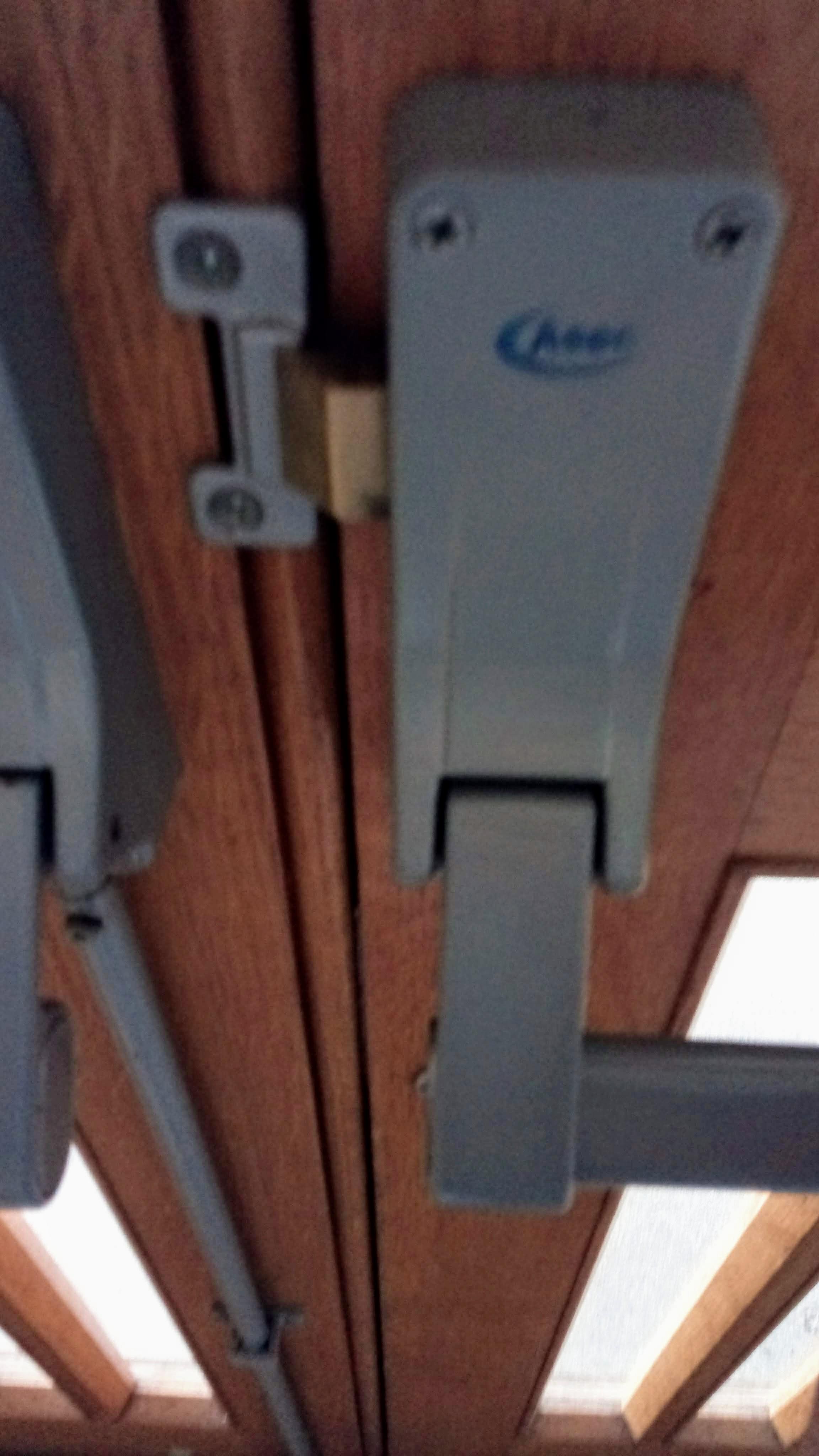

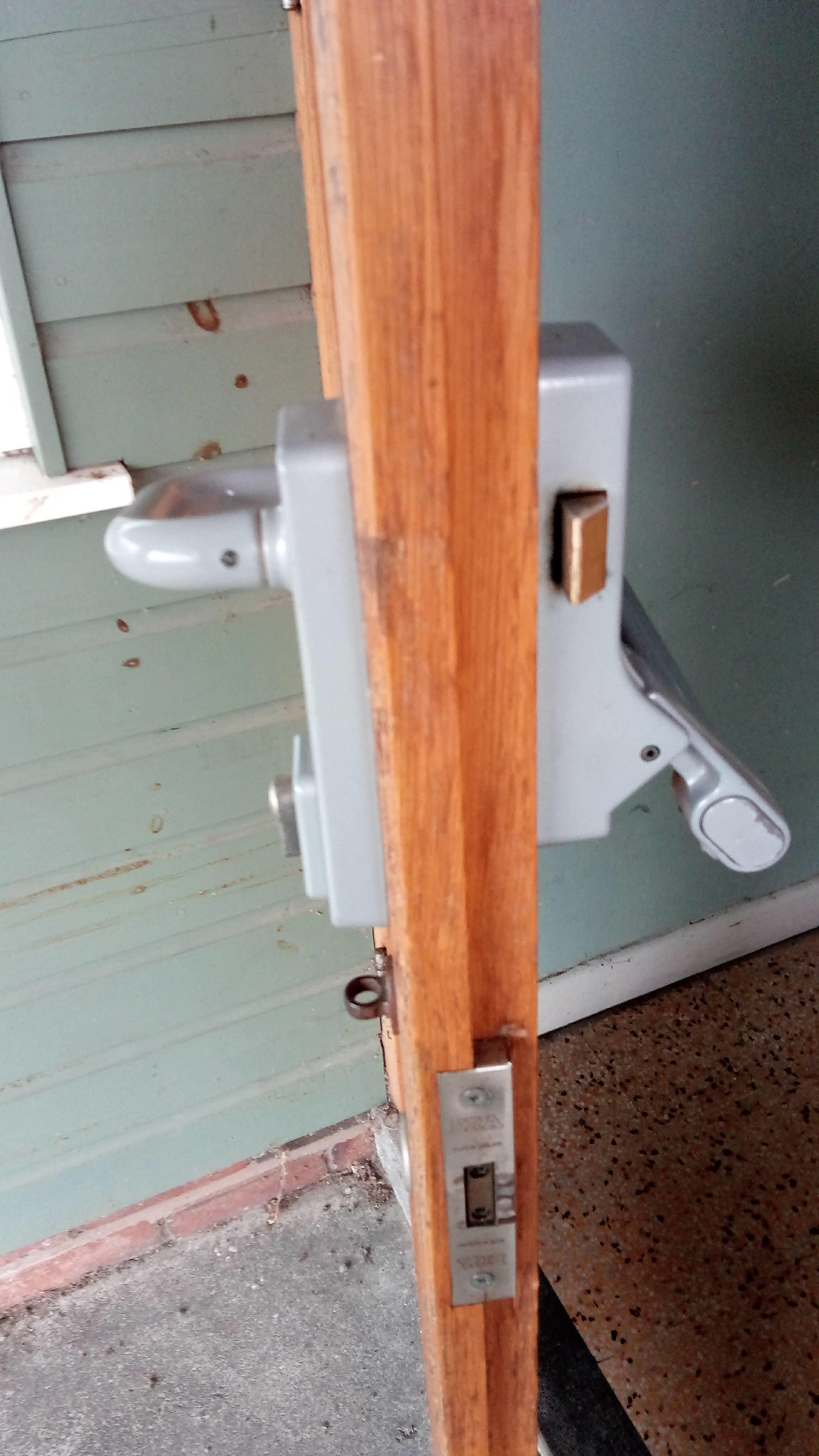

Max Posted March 8, 2019 Report Posted March 8, 2019 Hi, Our village hall has main double doors with an internal push bar mechanism and key-operated external access. If the door is locked with a key and opened by the push bar from inside it will lock again when it closes. This is fine most of the time but occasionally the hall is accessed by another door and we want to be able to unlock the main door from inside without a key. Is there a product available that would do this? I'm imagining a set up with A push bar that ALWAYS unlocks door from inside Key to unlock from outside Internal thumb latch or similar that can unlock or lock door from inside (but that does not override the push bar mechanism) This would allow people who came in to lock or unlock the main doors for general access without having to have a key for this door. Grateful for any advice. Thanks Quote

Guest Max Posted March 13, 2019 Report Posted March 13, 2019 On 12/03/2019 at 18:12, Safelincs said: Hi Max, could you please upload a photo? I can't quite understand your concern regards rebated door. Obviously you will have one leading leaf. The hold-back feature is integral to the push bar system and cannot be retrofitted. Harry Thanks Harry, The exodir 284 is not designed for rebated doors and the 285 (which IS designed for rebated doors) does not come with a hold-back option unfortunately. The active leaf has a push-bar that operates a latch. Would I be able to replace this single door mechanism with a new push-bar that has a hold-back function? The other door would remain operated by a bolt mechanism. Cheers, Max Quote

Safelincs Posted March 15, 2019 Report Posted March 15, 2019 Hi Max You are right, the 285 panic bar for double doors is the correct solution for rebated double doors. After a bit more digging I also found out that there is actually an accessory to achieve the hold-back/dogging functionality. The Exidor 299 allows the retrofitting of a holdback. Please see below. If you are interested, I we can get you a quote. Please direct message me. Harry Quote
Max Posted March 15, 2019 Author Report Posted March 15, 2019 6 hours ago, Safelincs said: Hi Max You are right, the 285 panic bar for double doors is the correct solution for rebated double doors. After a bit more digging I also found out that there is actually an accessory to achieve the hold-back/dogging functionality. The Exidor 299 allows the retrofitting of a holdback. Please see below. If you are interested, I we can get you a quote. Please direct message me. Harry Hi Harry, Thanks for your response, although I don't think the accessory would work on the active leaf of our door - as there is no bolt mechanism, just the latch shown in the photos. I have found a latch-mechanism active leaf pushbar with a hold-back facility elsewhere and will get this to replace the existing push bar. Thanks for your help tho. Cheers, Max Quote
