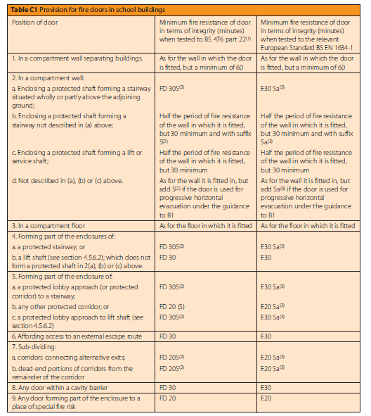

Both BB7 the old design guide for fire safety in schools & BB100 the current guide take a different approach to fire doors than you would see in other types of building.
Classrooms off a corridor that isn't a dead end don't require to be fire doors (unless an area of high risk like some labs) - so whilst they often still install fire door blanks with vision panels anyway they don't require self closers.
