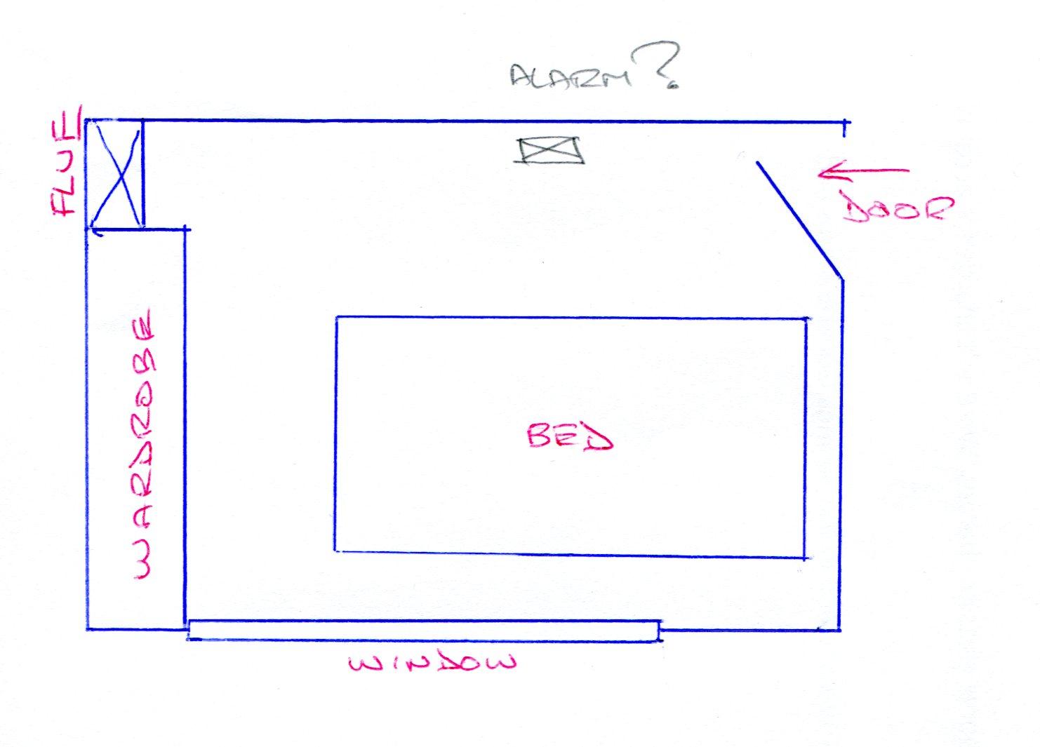

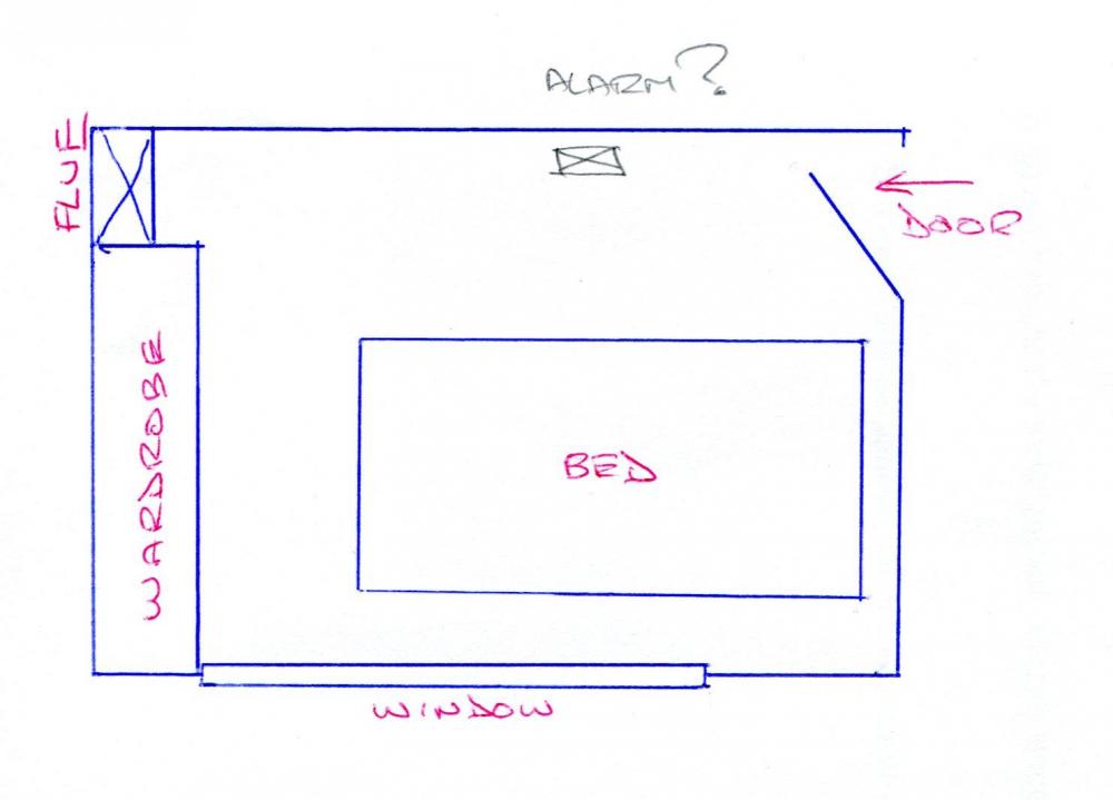

Nemo2000 Posted December 25, 2018 Author Report Posted December 25, 2018 I've now done what I ought to have done in the beginning and made a sketch ! There are a number of small shelves (not shown) fixed on the face of the flue wall, so IMHO that corner is a bit of a 'dead air' area. Obviously it can't be fixed to the front of the wardrobes, as they are all sliding doors. I'm thinking of putting it about half-way along the longer interior wall as marked. It may be a bit close to the door ??, but there are various other things on the wall between that position and the flue, so it's the best clear space. Otherwise it would have to be immediately beside the bed on one side or the other, in which case it would probably deafen me if it went off! Quote
Safelincs Posted December 27, 2018 Report Posted December 27, 2018 Hi, that seems like a reasonable compromise to me, although I would ideally like to see it closer to the flue and further away from the door. Harry Quote
Nemo2000 Posted December 30, 2018 Author Report Posted December 30, 2018 Thanks. Sadly, there is a large mirror bang in the middle of that wall :-( Quote
