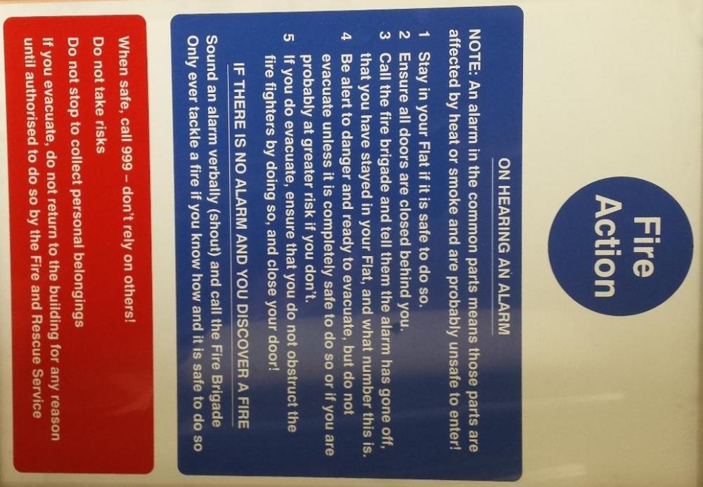

AnthonyB Posted November 15, 2018 Report Posted November 15, 2018 The first two were clearly out of their depth, the third was nearest to what the current benchmarks state - it would be correct in a post 2000 building regulation compliant stay put premises to not have a fire alarm system or domestic detectors and just have smoke detectors to operate the AOV's. Deaths have occurred in stay put flats where common area only detection with alarms (which would only activate if there was a fire in the common areas, an unusual occurrence and often associated with arson or charging mobility scooters) has brought people out of the 1 hour safety of their flat into a fire and smoke filled landing. It's therefore correct to suggest the erroneously installed smoke alarms be removed (or at least it be clear in the procedure given to tenants that hearing a common alarm may mean there is danger so take care if investigating and staying put may be safer) . As long as the fire service can access the AOV manual controls (which they can from your info) then your solution to a building specific issue should have been accepted and rubber stamped by the FRA. Too many under trained persons doing residential FRAs using the wrong guidance and ticksheets or point and click mobile report apps unfortunately. Quote
