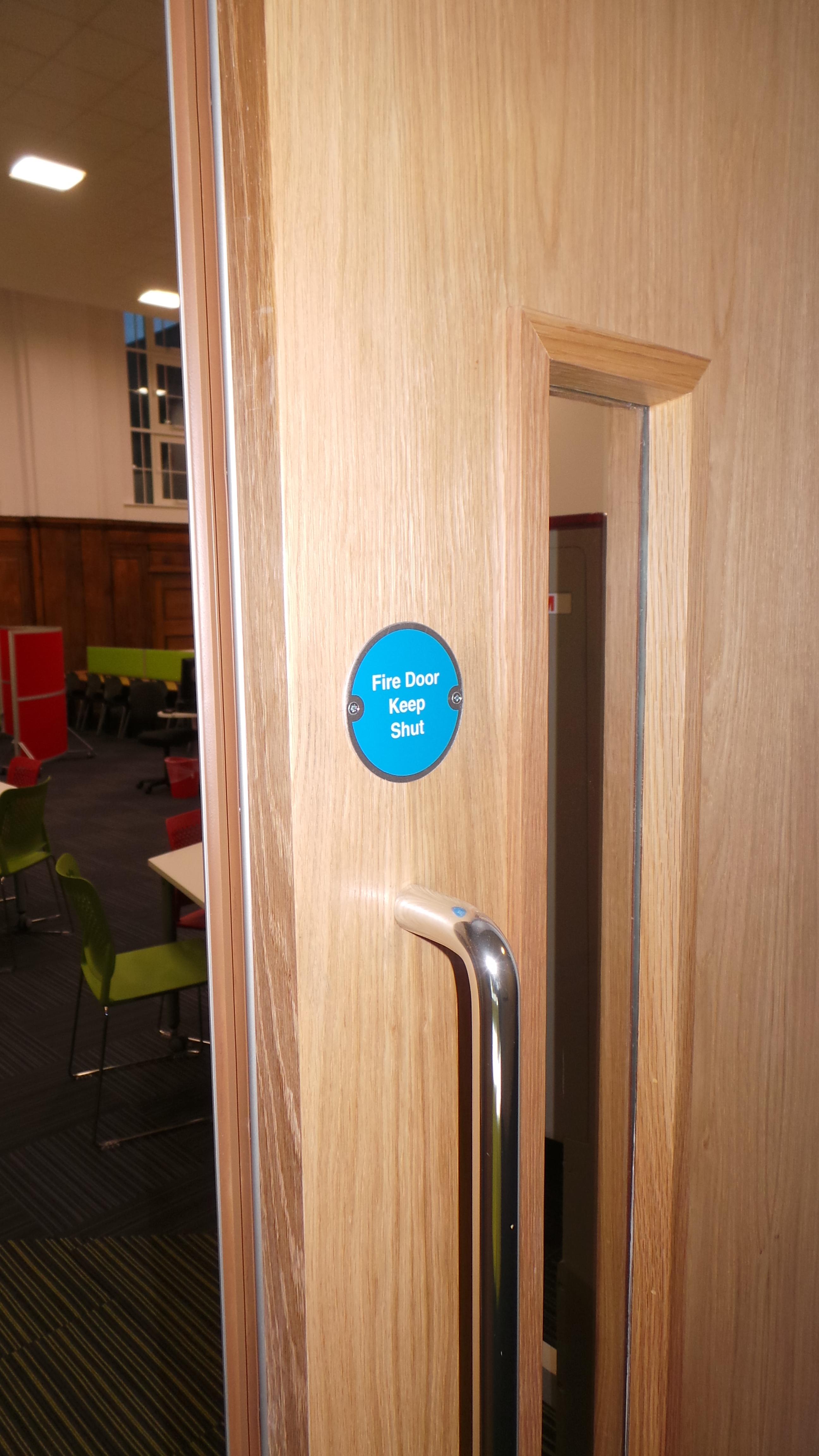

I can only speak about our fire doors, but our glazed fire doors would not work with your proposed sliding mechanism as the wooden edging around the glass protrudes (see image) and would catch.
