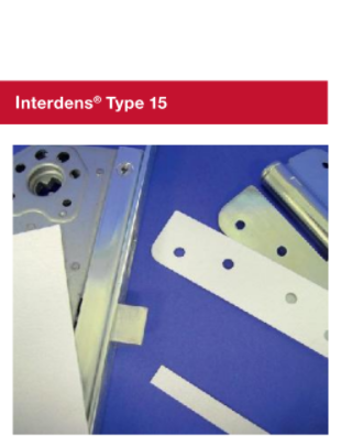

Guest John Posted January 13, 2022 Report Posted January 13, 2022 Hi Neil, We currently have doors with over the 4mm gap and no amount of adjustment is complying with the regulations. Can you pack hinges on a fire door? I think I read about suitable solid packing, not sure if that's just the door frame. Quote
Neil ashdown Posted January 14, 2022 Report Posted January 14, 2022 Hinge blades may be packed with intumescent sheet materials. eg. Quote
