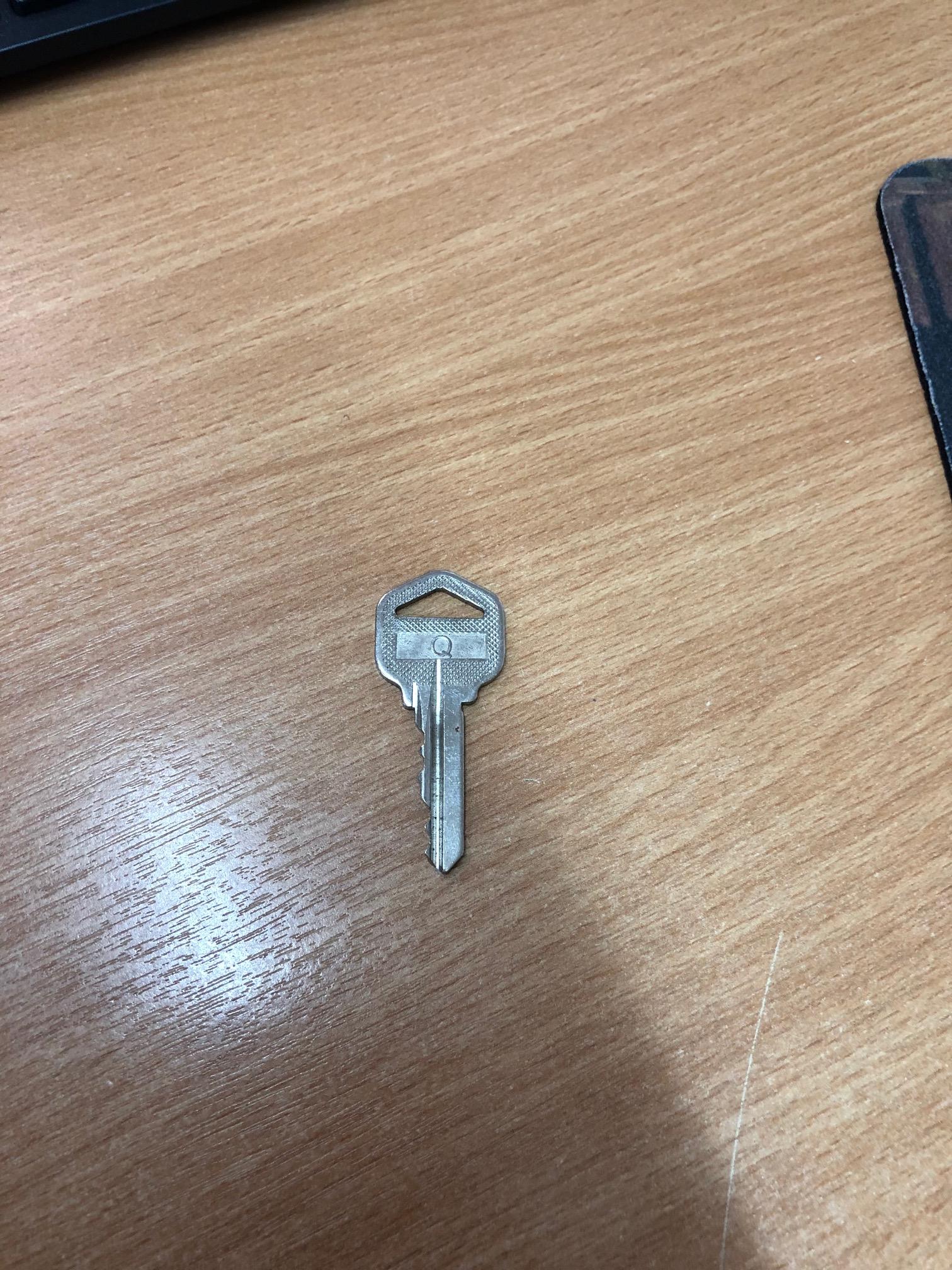

Guest Dan@m-fire Posted June 7, 2019 Report Posted June 7, 2019 I know exactly what you mean. Dry riser Q key. I have a couple of spares in our appliance. Quote

Guest Kev Posted June 15, 2021 Report Posted June 15, 2021 The Q-key for dry risers is called Queen key, Also there are 3 different keys for cabinet boxes and they all look very similar to each other. Quote
Guest Martin Fire and Light Posted June 21, 2021 Report Posted June 21, 2021 Hi, Does anyone know where i can get the queen keys as none of the cabinet manufacturers have a clue ?? cheers Martin 07970165433 Quote
