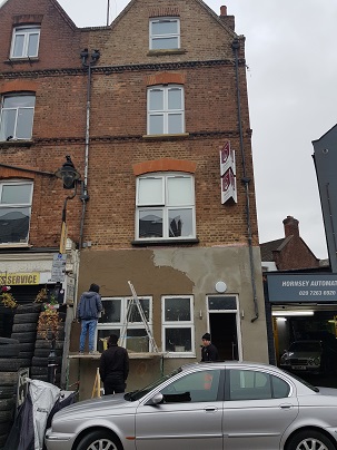

I am currently doing a FRA for communal areas only for a 4 storey building which has 3 flats (2 occupied at the moment) ground floor being refurbished into a flat as was old cab office.
There is a management company looking(owns) the building and they have instructed us.
