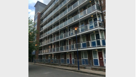

do the flats in the picture attached need full fire doors with self closing devices? They open on to a balcony but it’s in the open air and not a corridor?
Depends on the risk assessment - if you needed fire doors you would have to reglaze the whole block too if not fire resistant glazing. It's often not required in this scenario due to being open air
