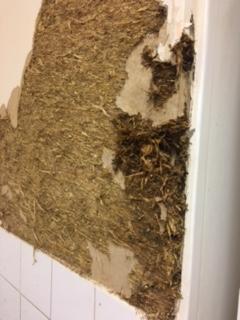

Guest David Posted February 2, 2018 Report Posted February 2, 2018 Hi Can someone please give me advise on the picture attached. This is the construction of a flat wall in a small purpose built block of flats. This is like straw construction with a skim over the top. The flats are on a stay put policy and I’m pretty sure there needs to be 60 minutes compartmentation for a stay put in flats. Will these wall last for 60mins, or are they dangerous? Any information welcome Quote
Tom Sutton Posted February 5, 2018 Report Posted February 5, 2018 It is called Stramit Board and was used about 40 years ago search the web for more info. Quote
AnthonyB Posted February 5, 2018 Report Posted February 5, 2018 Thanks Tom! Never seen it before - you should get 30 minutes Fire Resistance from a intact panel according to the manufacturers.. Quote
Tom Sutton Posted February 5, 2018 Report Posted February 5, 2018 David needs to check out where it is being used also what is the the fire resistance of the construction between each flat and the common areas. Quote
Guest Andrew Chapman Posted April 17, 2022 Report Posted April 17, 2022 On 02/02/2018 at 21:40, Guest David said: Hi Can someone please give me advise on the picture attached. This is the construction of a flat wall in a small purpose built block of flats. This is like straw construction with a skim over the top. The flats are on a stay put policy and I’m pretty sure there needs to be 60 minutes compartmentation for a stay put in flats. Will these wall last for 60mins, or are they dangerous? Any information welcome https://assets.grenfelltowerinquiry.org.uk/BRE00000967_DETR Framework Project Report - Investigation of real fires April 1999 - March 2000.pdf Page 42, for poor fire behaviour of stramit compartmentation. Quote
Tom Sutton Posted April 24, 2022 Report Posted April 24, 2022 Which walls are constructed with stramit, is it the inernal walls or the external walls of the flat and does any any walls expose the straw. Quote
