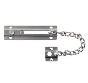

In a house to flat conversion, where the front doors to each flat (FD30's) are technically internal doors, can I fit a door security chain / bar and if so would this need to be fire rated, as it's inside each flat? I've fitted thumb turn locks to each door, but would like some form of extra security for each tenant if this is allowed.
The flat entrance door as well as being a fire resisting door is essentially a security door too because it opens onto the common area. Therefore a face-fixed security chain like the one in the image below below is allowed.
It does not need to be fire rated because its purpose is solely security and it has no contribution towards the fire separation qualities of the door BUT it must not interfere with the self-closing action of the door.
You are right to fit thumb turns on the inside so as to aid safe escape from the flat in an emergency.
