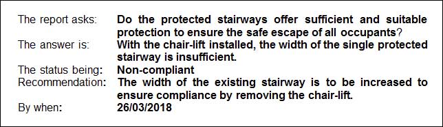

crl Posted February 28, 2018 Author Report Posted February 28, 2018 Sorry to carry on with my concern over the removal of the stair lift. Today I have received a report on the recent FRA for the reason of the removal of the stair lift. Does this offer a valid reason for the removal of the stair lift? Quote
AnthonyB Posted March 1, 2018 Report Posted March 1, 2018 Possibly if full evacuation, but as the premises appears to be built as stay put & doesn't have a suitable and sufficient fire detection and warning system for full evacuate it's irrelevant as you aren't going to have everyone leaving at any one time anyway and the numbers involved even so are negligible. Quote

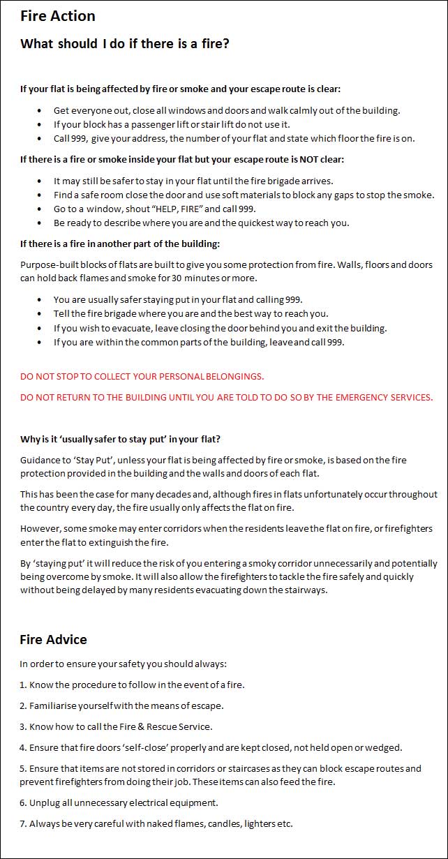

crl Posted March 1, 2018 Author Report Posted March 1, 2018 Thank you. I also thought that it was unusual for a "By When" date to be given for the recommendations to be carried out. Is this the normal procedure for a F.R.A? I have also made a new request to the HA after the new FRA, to request what fire escape policy is in place i.e a "simultaneous evacuation" or a "stay put policy" The information that I was provided with was (attachment) this does not specifically state what policy is in place. I questioned this information with the HA and I was just informed that is the correct policy on the information that they have sent. Be cause my complaint is due to go to the Ombudsman Services it is important that I have the correct information. Do you consider that the information that was provided by the HA is sufficient for informing the tenants on the correct policy that is in place? Quote
AnthonyB Posted March 2, 2018 Report Posted March 2, 2018 Looks like a modified version of the stay put fire procedure example in the flats guide which sort of blows the exit width excuse for withdrawing the stair lift out of the water. Actions in FRA's should be graded in levels of importance and it's common to give a suggested time frame too - this helps with budgets and prioritisation of works based on risk. Quote
crl Posted March 3, 2018 Author Report Posted March 3, 2018 13 hours ago, AnthonyB said: Actions in FRA's should be graded in levels of importance and it's common to give a suggested time frame too - this helps with budgets and prioritisation of works based on risk. The F.R.A reported that the stair lift obstructing the staircase was a Medium Risk. Quote
