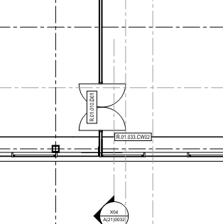

Guest Ian C Panting Posted July 5, 2019 Report Posted July 5, 2019 Could someone assist and recommends with Best Double swing hinges for FD30SC door-Refer to below caption, released as two escape route on Fire Alarm. Quote
Neil Ashdown MAFDI Posted July 6, 2019 Report Posted July 6, 2019 Best solution is to fit floor springs and pivots. See page 39 of the document Hardware for Fire & Escape Doors - Code of practice http://firecode.org.uk/Code_of_Practice_hardware_for_fire_and_escape_doors.pdf Quote
