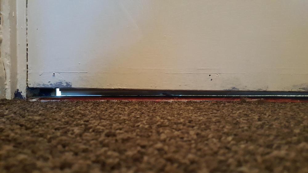

Guest Field Posted July 10, 2017 Report Posted July 10, 2017 When renovating a 3 storey house and putting in fire doors can a gap be left at the bottom of the door to allow for floor coverings to be added as I do not want to decide whether to have carpet or Karndean type flooring. I have been told that carpet or whatever has to be installed for the doors to pass Building Regs! Quote
Neil Ashdown MAFDI Posted July 11, 2017 Report Posted July 11, 2017 The gap at the bottom of the fire door is important. If the gap is too large, the issue is 1) That cold-smoke may spread from the fire side and 2) That cold air from the non fire side may be drawn under the door and feed the fire to aid its development. The maximum gap allowed for a fire door is generally 10mm between the door bottom edge and the floor covering. The maximum gap for a fire door with smoke protection is 3mm but if this is not possible a gap of up to 10mm is permissible with the use of a smoke seal to seal the gap at the door bottom edge. The easiest way to achieve the above is to use a hardwood threshold strip, that way you can get a consistent gap as well as avoid the door sticking on the carpet and failing to self-close. Quote

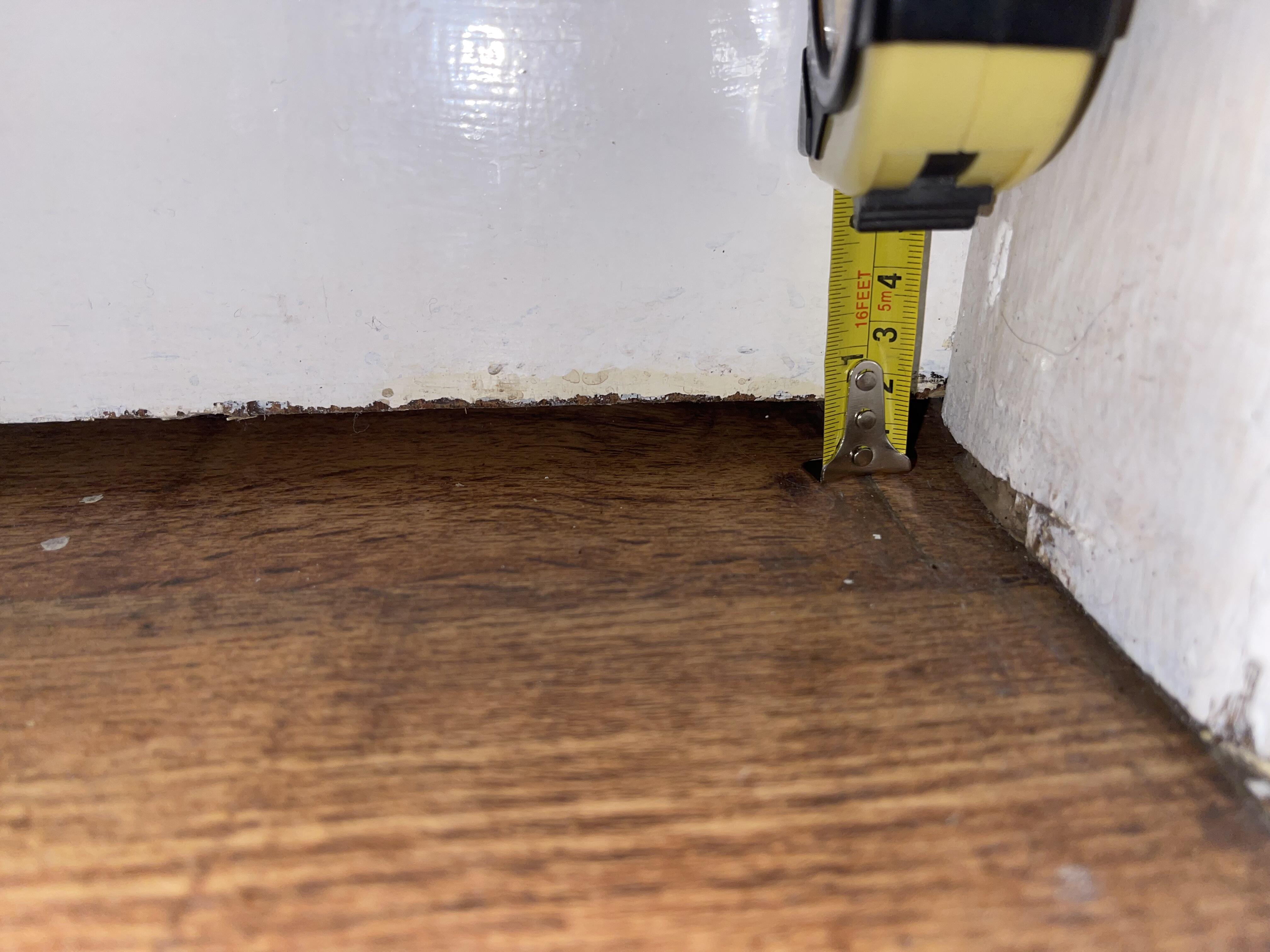

Guest Phoebe Posted June 13, 2022 Report Posted June 13, 2022 Hi there, I have an excessive gap at the bottom of my fire door. This is due to uneven floors in an old house- when the door is open the door is flush to the floor, but when the door is closed there is a gap underneath (greater at the opening). Fitting new fire doors would therefore not solve the problem. I have seen talk of threshold seals and drop down door seals. Can you advise if these need to be certified or made of specific materials, and whether they would work with slanted gaps? Many thanks Quote

Guest Phoebe Posted June 19, 2022 Report Posted June 19, 2022 On 13/06/2022 at 11:56, Neil ashdown said: A drop-seal will not resolve the issue of the door being non-compliant in terms of the 10mm gap for fire resistance purposes. If a drop seal does not make the door compliant, then what is the purpose/point in having a drop seal? I cannot achieve a gap < 10mm with a door due to unlevel floors in an old house (door has to be cut short at bottom to allow full opening). Does this mean there is nothing I can do to be compliant? I was hoping to use threshold plates + drop down seals to reduce gap, is there point in me spending the money if I can’t get doors certified anyway? Thank you Quote
Neil ashdown Posted June 22, 2022 Report Posted June 22, 2022 Hi Phoebe, For fire resistance purposes the max gap is generally 10mm, so you could fit a threshold plate to the floor to reduce the gap and then fit a flexible seal to address the cold-smoke spread issue. BS 8214: 2016 sections 9.5.3 and 12.3 refer. Quote
Guest Guest Graham Posted July 20, 2022 Report Posted July 20, 2022 If I have a 10mm plus gap at the bottom of a door could I not fit an aluminium kick plate of say 2mm thick to reduce the gap? Quote
Neil ashdown Posted July 26, 2022 Report Posted July 26, 2022 In terms of compliance with the British Standard, that would not be a suitable solution. If it's a new fire door leaf refer to the data sheet for details and if its an existing fire door fitting a threshold plate to the floor may be the easiest way to resolve the problem. Quote
