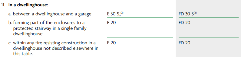

Guest Norma Posted August 29, 2023 Report Posted August 29, 2023 Do you have to fit intumescent strips with a fire door in a domestic house or can you have a fire door with no intumescent strips? Quote
AnthonyB Posted August 30, 2023 Report Posted August 30, 2023 On 29/08/2023 at 11:58, Guest Norma said: Do you have to fit intumescent strips with a fire door in a domestic house or can you have a fire door with no intumescent strips? If it's an existing older house that hasn't undergone relevant building work where current standards would be applicable then no. Quote
Neil Ashdown MAFDI Posted September 1, 2023 Report Posted September 1, 2023 For current building regulations refer to Approved Document B Fire Safety https://assets.publishing.service.gov.uk/government/uploads/system/uploads/attachment_data/file/1124733/Approved_Document_B__fire_safety__volume_1_-_Dwellings__2019_edition_incorporating_2020_and_2022_amendments.pdf Appendix C deals with fire doors Quote
