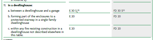

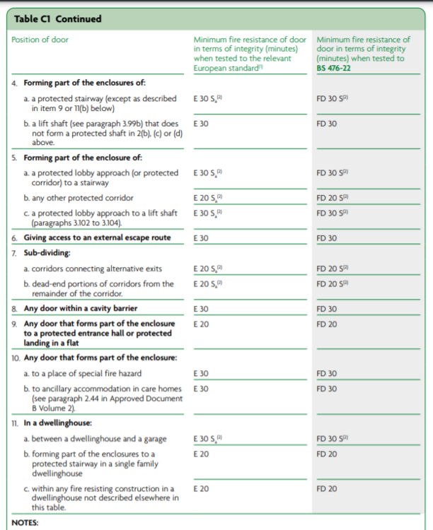

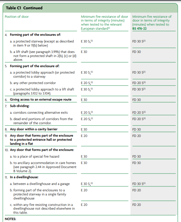

Neil ashdown Posted September 30, 2021 Report Posted September 30, 2021 Table C1 at page 138 of Approved Document B of the Building Regulations deals with requirements for fire resisting doors in dwelling houses with loft conversion https://assets.publishing.service.gov.uk/government/uploads/system/uploads/attachment_data/file/937931/ADB_Vol1_Dwellings_2019_edition_inc_2020_amendments.pdf For information about hardware / ironmongery for fire doors, consult the guidance document 'Code of Practice -Hardware for Fire & Escape Doors' at http://www.firecode.org.uk/ Quote
Tom Sutton Posted September 30, 2021 Report Posted September 30, 2021 Yes when you provide new fire doors all the fittings have to be up to standard as indicated in "Code of Practice -Hardware for Fire & Escape Doors" also the guidance in ADB vol 1. Quote

Neil ashdown Posted December 29, 2021 Report Posted December 29, 2021 Maybe the doors could be upgraded to improve their fire resistance performance. Historic England https://historicengland.org.uk/images-books/publications/fire-resistance-historic-timber-panel-doors/ Building regs Page 135 Fire doors https://assets.publishing.service.gov.uk/government/uploads/system/uploads/attachment_data/file/937931/ADB_Vol1_Dwellings_2019_edition_inc_2020_amendments.pdf Quote

Neil ashdown Posted April 9, 2022 Report Posted April 9, 2022 In a three storey house, in scope of building regulations, doors opening onto the staircase, landings and hallway should be fire doors. This is so that the doors, when closed, would protect the entire escape route from top floor to the entrance door from fire spread. So if the kitchen opens onto that route, then it should have a fire door. Also, any door inside the house to an integral garage should be a thirty minute fire door with self-closer and smoke seals. Quote
