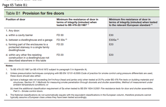

Tom Sutton Posted April 29, 2019 Report Posted April 29, 2019 This project is subject to the Building Regulations and the architect and the builder are required to carry out the requirements of the building control inspector (BCI) to get the completion certificate, which they need to give you on completion of the contract, to prove the works meets the requirements of the building regulations. Two storey dwelling houses were fitted with FD20 doors, and substantial, well fittings standard doors were considered to meet that standard. (Nominal door) However, if they should fail, it was considered the occupants could drop from open windows to escape. However, a three storey dwelling house, escape via a window was considered unacceptable, because of the increased possibility of serious injury, so a 30-minute standard means of escape was required. The architect will have produced drawings most probably according to Approved Document B (fire safety) volume 1: Dwellinghouses which would show a means of escape from the third floor to the front door meeting a 30 minutes standard, also the door to the integral garage needs to be an FD30s with a self-closer. All habitable rooms, (excluding bathrooms) off this escape route should be fitted with full FD 30 doors but it appears the architect has agreed with the BCI that these doors can be upgraded, except the loft door. Fire Doors are tested from both sides because when hung, either side could be facing the risk side, but this is not the case for existing doors because the risk side is easily identified, so I would argue that only the risk side need to be upgraded, but it looks like the architect has not convinced the BCI. It is understood by many that manufacturers consider it does not make economic sense to get doors tested to FD20, because D30 fire doors will meet both standards so you will find very few for sale. Also because in the past, unscrupulous manufacturers claimed their FD30 doors, including other fire safety products, had been tested, which was not true, so now inspectors require documented proof. Without full access to all the details, I cannot give a definitive reply and the best advice you can get will be from your local building control. Quote

Tom Sutton Posted July 5, 2019 Report Posted July 5, 2019 All doors except external doors in a single occupancy domestic home should be FD20 doors and as you have FD30 doors you meet the requirement. Fire doors do not require self closers except any doors between the house and an integral garage. So you do not need to fit, hold open devices but if you do wish to fit them, then this is the wrong forum for you, check out fire alarm engineers forum http://firealarmengineers.com/forum/. Check out Approved Document B (fire safety) volume 1: dwellinghouses. Quote
