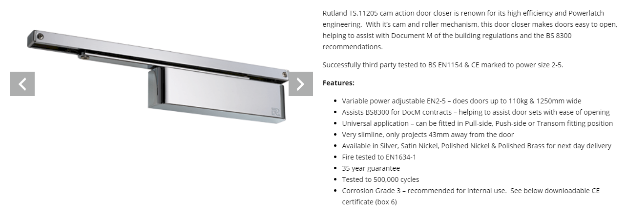

Guest Guest/England Posted May 3, 2021 Report Posted May 3, 2021 I live in a flat in England. The front door has an automatic closure fitted, which I think is required by the building regulations. Due to mobility problems, it is difficult to open the front door, although I have had it adjusted for the closing speed. Is there a legal requirement for me to keep this closure operational because if there should be a fire in my apartment, I would find it difficult to open the door to get out in a reasonable time. Quote
Neil ashdown Posted May 5, 2021 Report Posted May 5, 2021 This type of self-closing device is designed to be easier to open. Contact the manufacturer to find out which device is best suited to your needs and that of the flat entrance door as these must be self-closing fire doors with restricted spread of smoke. Quote
