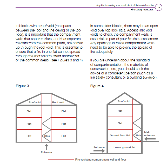

Guest Victorian terrace Posted June 9, 2022 Report Posted June 9, 2022 I live in a 1900 building that was converted into flats in the 50's. The loft space is open, and not seperated by flats. Do they HAVE to be seperated in the loftspace. If so, what is the least intrusive, most economical way of doing it. Thankyou very much. Quote

AnthonyB Posted June 22, 2022 Report Posted June 22, 2022 On 10/06/2022 at 00:09, Guest Victorian terrace said: I live in a 1900 building that was converted into flats in the 50's. The loft space is open, and not seperated by flats. Do they HAVE to be seperated in the loftspace. If so, what is the least intrusive, most economical way of doing it. Thankyou very much. Sheet based fire barriers & wire reinforced mineral wool barriers are sometimes easier to fit than blockwork or stud and plasterboard. Yes an open cavity is a significant risk and has been involved in fatality and high loss fires. Quote

Guest Loft small flats safety Posted June 18, 2023 Report Posted June 18, 2023 I live in a small block of flats owned by a housing association. The block comprises of four flats, two flats upstairs and two flats on the ground level, there is also a communal stairs and passageway. My question is that it appears that there is no fire insulation or wall divide in the loft between the top two flats. Is there a legal requirement to have a fire break etween adjoing flats.....It can also. E a security risk. Quote
