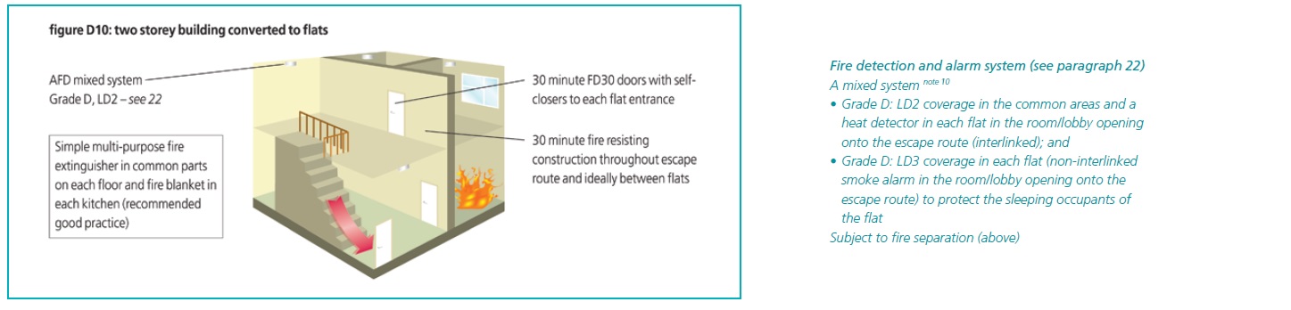

Guest 2 flat house Posted October 15, 2020 Report Posted October 15, 2020 Hello , I'm currently upgrading the smoke detection system in a house converted into 2 flats ( both separate levels ) into a hard wired system , the flats share a front door entrance with the light in the entrance ( hallway ) being supplied from the downstairs flat , so i am initially taking the supply from there for the system . Do both flats need to be interlinked in this situation ? Andy Quote
AnthonyB Posted October 15, 2020 Report Posted October 15, 2020 The attached image summarises the guidance. Quote
