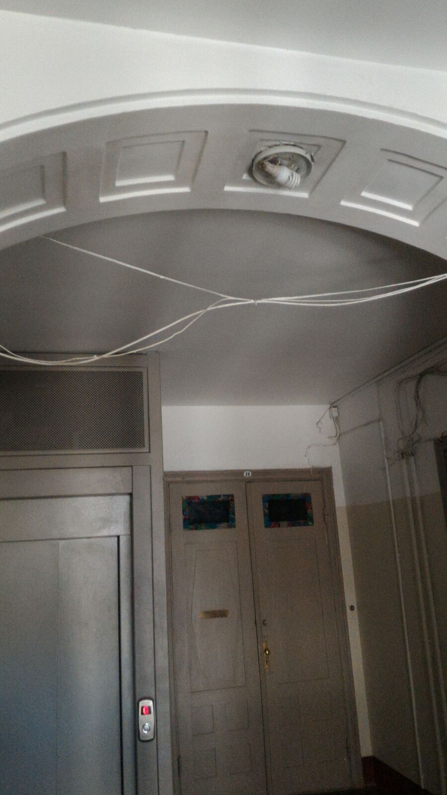

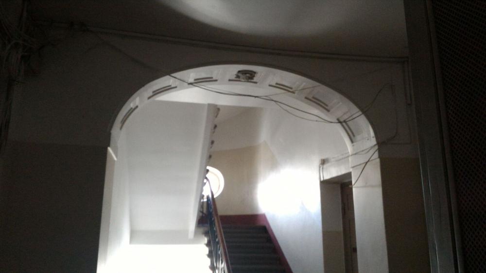

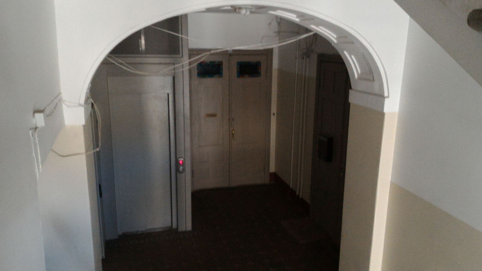

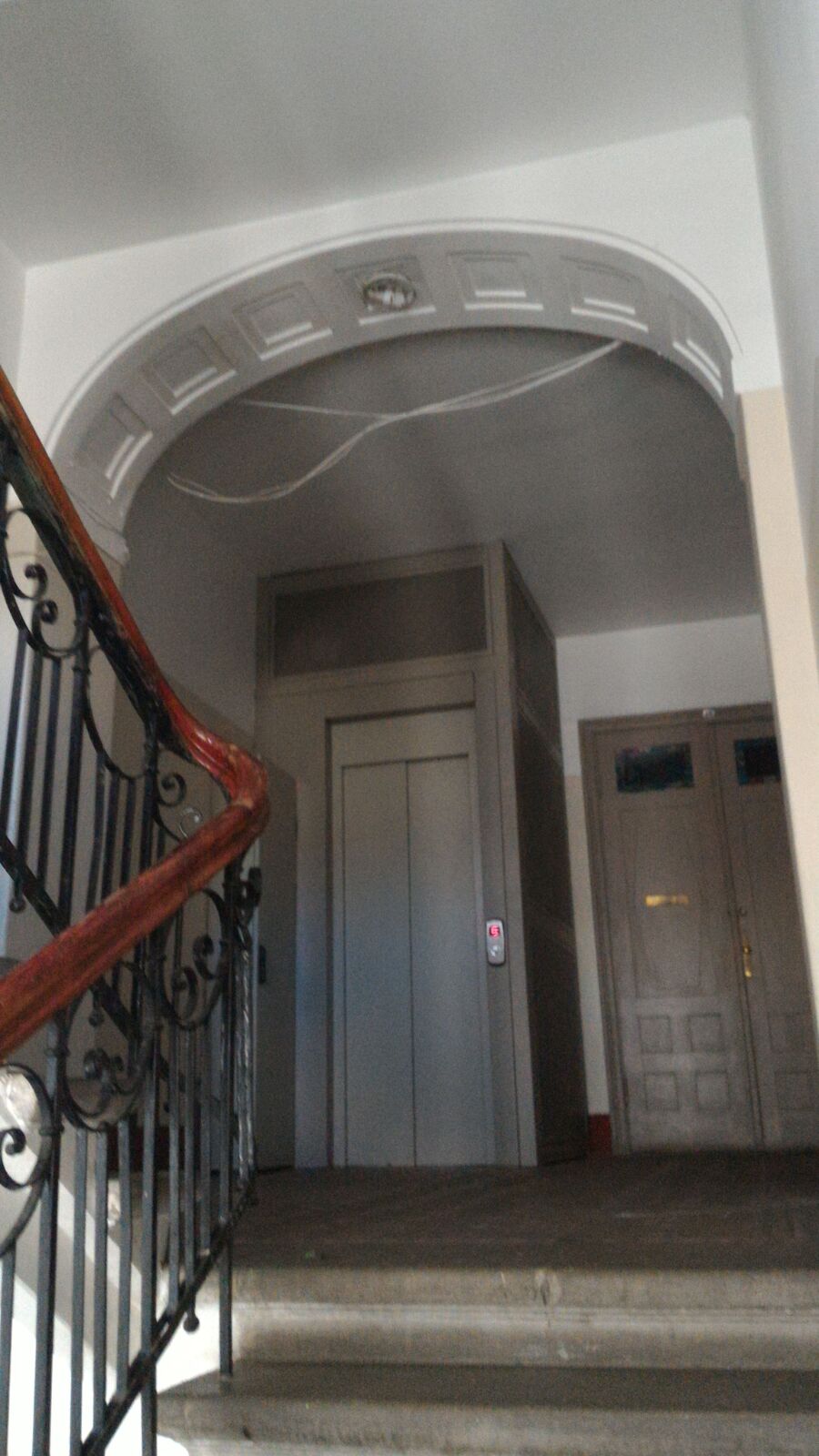

We decided to install smoke detector in stairway of our 7 storey building. We are private renter there and invested for the safety of all. We contacted a security company. I just would like to make sure about the location of smoke detector (1/stair).
Please find attached picture of 1 level. All are similars.

Is this part of a fire risk assessment and what grade of fire alarm has been fitted. The arch creates a well on the lift side, which would have to fill with smoke before the detector operated, creating a delay. What is the loose wires and why did you employ a security company instead a fire alarm company?

I thought similar, but then I looked again, that is a light fitting in the centre of the arch.
I think (but am not sure) Tomcat wants advice as to where to put the smoke detector?  But I agree with Tom, the arch will make a partition, so ideally it needs two smoke detectors, one either side of the arch.
