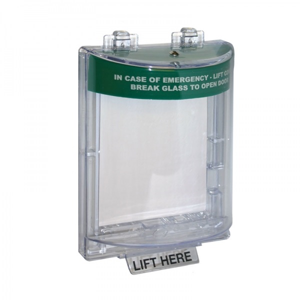

RFCally Posted January 11, 2017 Report Posted January 11, 2017 This is what you need. Its called a Stopper Unit which alarms when you lift the cover before you get to the break glass. I have used these successfully in one of my nursery units. They are available from many commercial fire and security retailers. Regards Alistair Quote
Safelincs Posted January 12, 2017 Report Posted January 12, 2017 Hi, I hope the readers won't mind if I suggest a page from Safelincs' commercial website showing a range of these green access control covers Harry Quote
