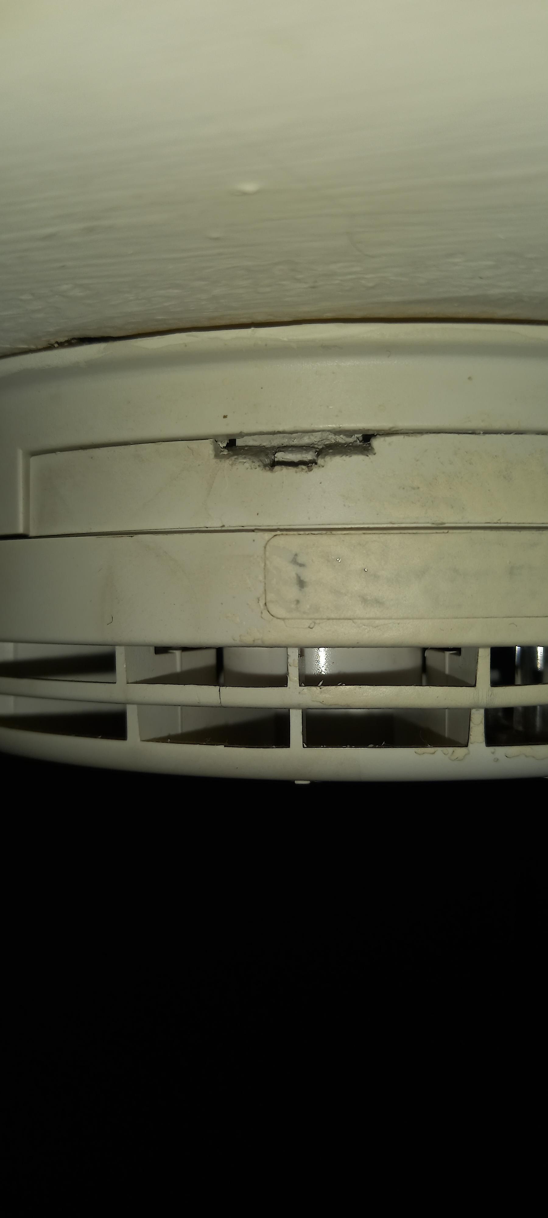

Guest Emma Posted December 24, 2015 Report Posted December 24, 2015 Hi - my smoke alarm started beeping last night so I decided to try and take the battery out. I think it's the Ei141 model. I turned the mains power off, but I can't for the life of me remove the cover to get the battery out. I've tried all kinds of different screw drivers inserted where instructed but the alarm cover WILL NOT slide off. Last night I gave up and have been trying again today with no luck, and have now broken some of the plastic around where the screw driver goes in so there now doesn't appear to be any little latch to lift off - but the alarm still wont budge! The alarm is right outside our bedroom doors and none of us are going to be able to sleep tonight unless I can stop it! aargh! How do I get the damn thing off? Why do they make it so hard to remove!!!!! I feel like just smashing the thing to get it off!\ Thanks for any help anyone can offer. I've tried called the Safelincs number but being Xmas Even no-one is answering! Quote

Guest Daniela Posted February 15, 2023 Report Posted February 15, 2023 It looks like my clip is broken and the device will not budge. 5 different people have tried the move the bloody thing, how do I smash the thing off with no damage to the ceiling so I can stop my ears from hurting, and get a new one fitted. Quote

green-foam Posted March 13, 2024 Report Posted March 13, 2024 It will carry on beeping until the battery is replaced. As it uses so little energy to do this, it can continue for as long as a month. Sorry to hear you are having problems, but it is as easy as shown in the video above. You need to stay where you are as you insert the screwdriver as shown in the first picture. I have found that a "terminal" screwdriver works just as well, after inserting it, GENTLY pull down (If the detector is mounted on the ceiling) This releases the catch, then push the main unit (The part with the LEDs) forward. (Away from you) You are correct, the Ei141 does contain radio active material, it is also now obsolete, and should be changed for the Ei146E which is an optical smoke alarm. Quote
