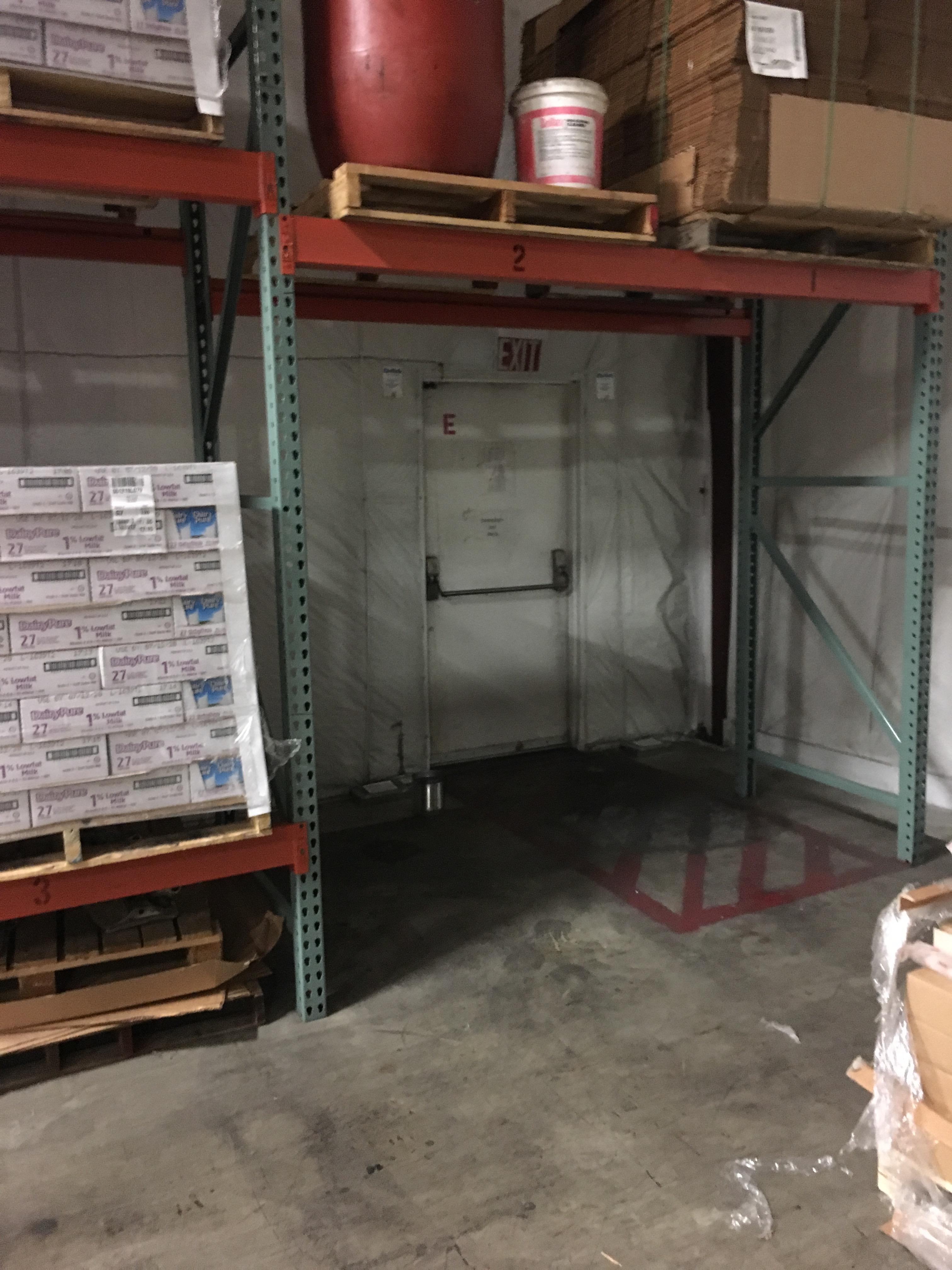

Guest JenniferH Posted August 1, 2019 Report Posted August 1, 2019 Are fire exits allowed to have racks with pallets full of product going directly over them? It seems to me that it would be a flammable hazard that could potentially block the exit. Quote
Tom Sutton Posted August 17, 2019 Report Posted August 17, 2019 IMO this situation is acceptable and if the fire originated in this area, this exit door would most probably not used. The only criticism is the fire exit sign, I believe another one should be fixed on the front of the racking opposite the door, pointing to the exit door. A further observation the exit sign above the door would better indicate the door if it was an illuminated sign. Quote
