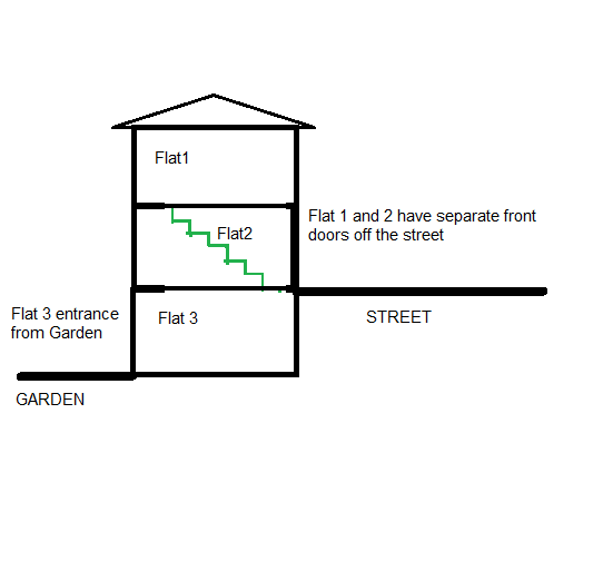

Guest WalesMark
Hello,
I have a building with 3 flats, each with separate entrances off ground level as my sketch attached. Each flat is 2 bedrooms and is 12metres deep.  Is a FRA required in this case? I would appreciate all assistance and thanks in advance.
