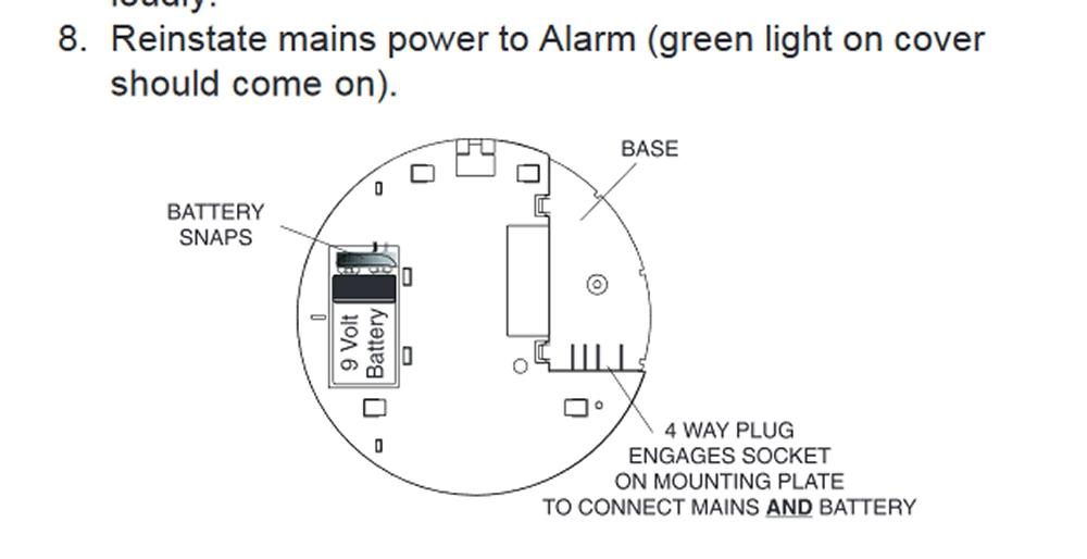

Guest DonGilders Posted June 23, 2023 Report Posted June 23, 2023 In the garage, and above, we have 3 interconnected heat alarms that until a few weeks back had been working fine - batteries changed a couple of months back. Now, two of the alarms (in the garage store and stairwell) show green power and red blinking at 1 sec intervals. The third, in the garage, shows green and a flickering red. Occasionally the third random beeps. I bought a replacement Ei144 Heat alarm and slid it on to the garage alarm base and tested the horn OK. I reconnected the power and the new alarm still had red flicker, and the other two had red blinking at 1 sec intervals. Any help would be appreciated? Please could you confirm that the base does nothing but conduct the power and interconnection? Quote
green-foam Posted June 26, 2023 Report Posted June 26, 2023 On 23/06/2023 at 15:23, Guest DonGilders said: Please could you confirm that the base does nothing but conduct the power and interconnection? It seems it depends which base you have. I googled and found a base that has a "hidden" battery (But I can not find a definitive answer.) The only other thing I can suggest is call Aico direct, it would also be appreciated if you could post back with the results. Quote
Guest Ed Addis Posted January 6, 2024 Report Posted January 6, 2024 Can I just clarify one thing please? If the alarm beeps and you remove the detector from the base and change the battery, will it still beep until it's re-fitted and powered up again? Quote
green-foam Posted January 8, 2024 Report Posted January 8, 2024 Aico smoke alarms disable the battery when the smoke alarm itself is removed from the base. Doing this means the smoke alarm is non functional Quote
