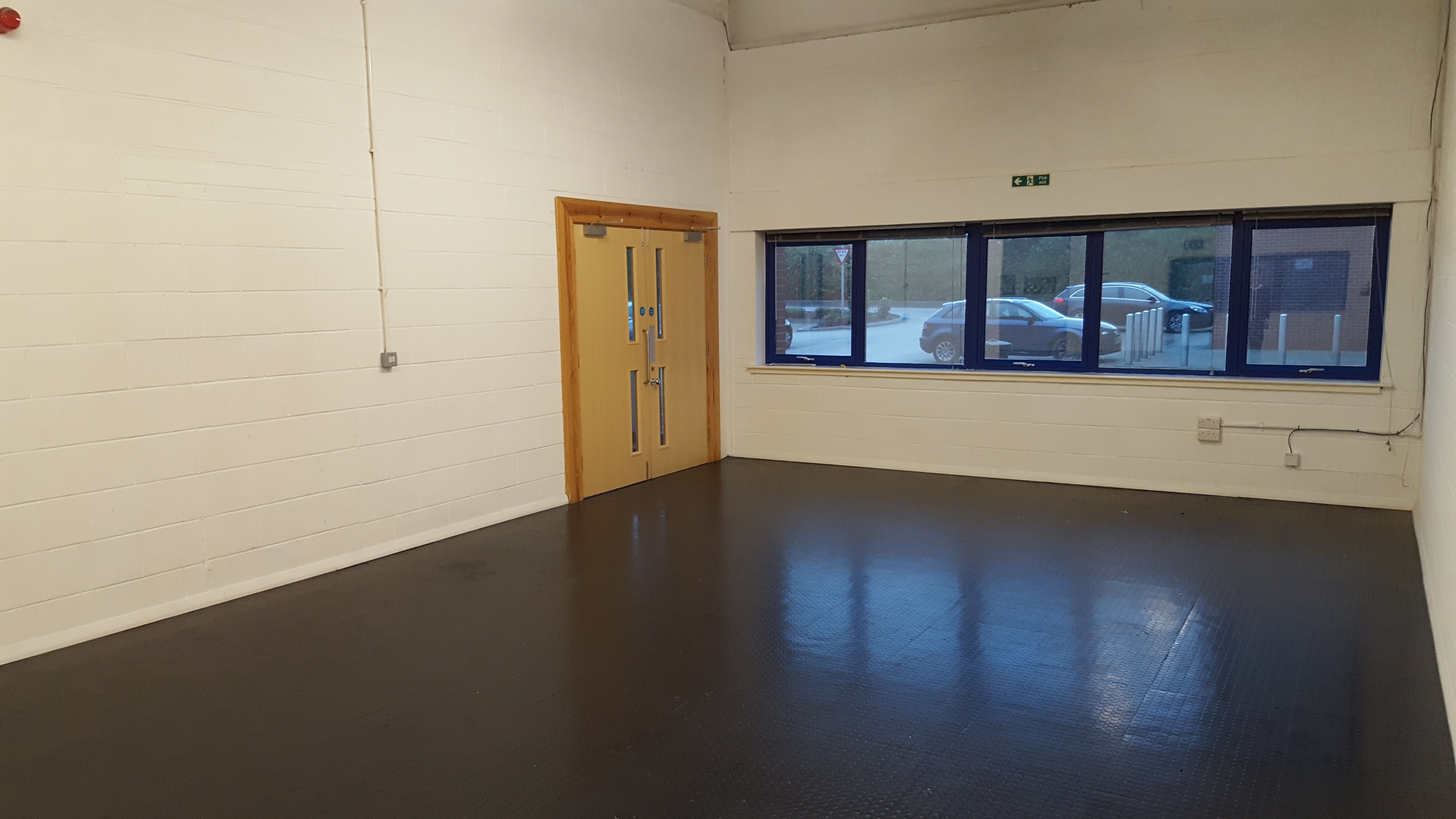

Guest DavidC Posted October 18, 2017 Report Posted October 18, 2017 Some great information here, hope you don't mind me asking my own question. I've just leased a workshop unit on an office block. I share a corridor with another tenant. So there is an entrance door into a shared corridor, then a door on the left which is mine and a door to the right which is his. The two units are designed as one but has now been split. I met with the other tenant recently and he told me that I was not allowed to use my door on the left as an entrance, that it had to be kept shut for fire safety regulations and that I had to use the back entrance. He said he had this in writing and that he would be shut down if we didn't follow this. I've attached a photo of the wooden doors he says I have to keep shut and a photo of the rear blue doors he said I'm suppose to use as my entrance. I'd really appreciate and comments on the matter. I'm waiting to hear back from the landlord as we speak. From reading other comments here and learning more about the door types I can't see any truth in what he has told me. Quote
AnthonyB Posted October 18, 2017 Report Posted October 18, 2017 Sounds like utter rubbish to me as there is nothing in any of the fire safety guides to support this and I think that the other tenant is just wanting to keep the main entrance for themselves. As long as the double fire doors are fitted with self closer and not wedged open there is absolutely no reason not to use them as a personnel access point. Also the BS radar is beeping with the reference to 'closing down'. The way Fire Safety enforcement works is that Prohibition Notices are rarely used and usually reserved for sleeping risk premises with multiple issues such as poor compartmentation, inadequate fire detection & alarms, i.e. an immediate risk of death or serious injury. In commercial premises as yours most breaches are dealt with informally by a fire safety letter (often called a notice of deficiencies/agreed action plan/etc) only escalating to a formal Enforcement Notice for continued non compliance or particularly severe/multiple offences. Quote
Guest DavidC Posted October 19, 2017 Report Posted October 19, 2017 17 hours ago, AnthonyB said: Sounds like utter rubbish to me as there is nothing in any of the fire safety guides to support this and I think that the other tenant is just wanting to keep the main entrance for themselves. As long as the double fire doors are fitted with self closer and not wedged open there is absolutely no reason not to use them as a personnel access point. Also the BS radar is beeping with the reference to 'closing down'. The way Fire Safety enforcement works is that Prohibition Notices are rarely used and usually reserved for sleeping risk premises with multiple issues such as poor compartmentation, inadequate fire detection & alarms, i.e. an immediate risk of death or serious injury. In commercial premises as yours most breaches are dealt with informally by a fire safety letter (often called a notice of deficiencies/agreed action plan/etc) only escalating to a formal Enforcement Notice for continued non compliance or particularly severe/multiple offences. Thought as much, spoke to the landlord and he said it's rubbish. Thanks for replying. Quote
